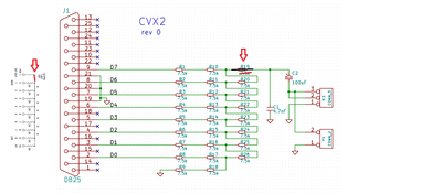

Reply 191 of 484, by dreamblaster
of course not, I think CVX misses a lot of bass, it sounds thin, but clear
I compared the FTL ladder with CVX ladder, it is almost identical,
FTL ladder misses one resistor :
on CVX-2 if we short R19, we should get it identical.
you can try by bridging R19 ?
(or replace it by a 0 ohm resistor)
Thanks for your support !

Reply 193 of 484, by dreamblaster
yes
i compared again and noticed it differs in 1 resistor :
CVX has 1 additional resistor R19, we should test by shorting this resistor
--> see illustration
60.12 KiB
1443 views
Reply 194 of 484, by Scali
Hum, that's the last resistor before it goes through the line-out? So all signal would pass through that. That might explain why the 100kOhm version I have is so very soft.
Reply 195 of 484, by dreamblaster
yes i think this is the last piece of the puzzle
with 100k this makes an RC low pass filter
that can fall in the audio range
so yes this could well be the reason for the more muffled sound
please replace that resistor with a 0 ohm resistor
or just bridge it.
i think it will sound good then !
Reply 197 of 484, by Jepael
dreamblaster wrote:
yes […]
yes
Absolutely right.
With this modification, the source impedance seen by the capacitor is dropped from 22.5kohms to 15kohms, so cutoff frequency will go up from 1.5 kHz to 2.25 kHz.
It will also sound louder without this resistor.
This is closer to the original, as what the patent says the cutoff frequency is about 3000 Hz with about 5nF capacitance.
But the patent numbers are inconsistent. They say the R=100k and 2R=200k, so R2R network impedance is 100k, and at the R2R network output, there's the extra 15k resistor to ground. This will both attenuate the R2R signal with a factor of 15/115=0.13, and bring down the source impedance seen by the cap to 15k||100k or about 13kohms. 13kohm and 5nF is 2.4 kHz filter, so 13kohm and 4nF would be 3.0kHz. So my guess is, the Covox cap may not be a 4.7nF but near it, someone should read the capacitor markings.
So, in light of this, it should be pretty close in theory, or even closer if the 4.7nF cap is replaced with two 2.2nF caps in parallel to get 4.4nF in total. If ceramic caps are used, my recommendation is to use NP0/C0G type if possible.
Then, the only differences left are the amplitude as dreamblaster's schematic does not attenuate the signal at all like the Covox original, so the output should be much louder in theory - maybe it is when the extra resistor is removed. Also because the R2R network resistances are lower, it presents somewhat heavier load on LPT data pins than original (mind you that the original IBM parallel port just directly drives the data bus with 74LS374 chip and it really is kind of weak to source much current into a load).
So anyway, they are different, so they can't sound identical even with same PC and same amplifier, but close enough anyway.
Reply 198 of 484, by MobyGamer
Okay, I was able to do that this evening (surface-mount resistors are smaller that I realized!) and made some recordings:
ftp://ftp.oldskool.org/pub/misc/temp/LPTDAC_c … al%20dream.flac
ftp://ftp.oldskool.org/pub/misc/temp/LPTDAC_c … t%20corpus.flac
The good news: It sounds brighter than with R19 in place.
The bad news: It still isn't near the clarity of the original Speech Thing. There's definitely some muddled frequencies, and an unintentional low-pass filter. Also, the output is louder (as expected), but it's almost too loud, louder than typical line-level output.
I could shunt the same resistor on the CVX-1 and make recordings, but since it also uses 7.5k/15k resistors, I don't think it will sound any better. Maybe it is time to change the design to use 100k resistors? I know the output level with the original design/patent is low, but it really sounds great (and looks great; bring the audio files into an editor with an FFT display and you can see the source frequencies are well-represented). Maybe it's possible to include a small amplifier on the board, if the goal is to output at line-level?
