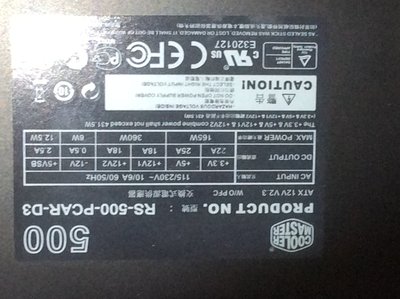

How are the rails of your PSU and how are they distributed?

Reply 3 of 123, by FFXIhealer
811.61 KiB
2630 views
And I know I'm "overreaching" the current hardware. The Radeon 9550 is a piece of shit. It's an ENTRY LEVEL card! I want an ENTHUSIAST level card, like the X850....but I wanted advice from people who've worked on this level of hardware. The CPU is only 1.53GHz, even though it's a Palomino core with SSE and 3DNOW. And it has 2GB of RAM now.
