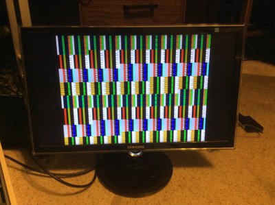

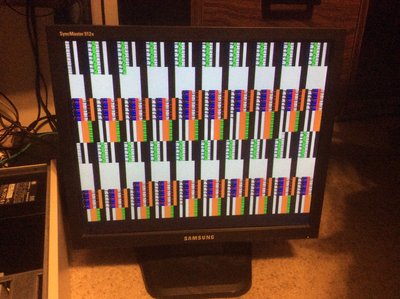

Reply 109 of 123, by FFXIhealer
UPDATE
So a few days ago I gave an offer to an E-Bay seller for an ATI Radeon 9800 XT 256MB AGP card and was accepted. The card came in today and I JUST took it out of the box and installed it.
The Good News: The system posted (single beep) and began booting into Windows XP (I could tell by HDD sounds and HDD light going nuts).
The Bad News:
1.23 MiB
1906 views
That's all I see, even during POST. I tried two different monitors...but it made no difference. So I just now tried a DVI monitor (one from my modern PC) and I got the same thing using a known-good DVI cable:
1.11 MiB
1906 views
I think the card is either hosed or just not going to work on this MB. I'm getting annoyed. This is now the 2nd video card "buy" and failure. And I have no other 8x AGP systems to test them on, so I have no idea if the card is ACTUALLY hosed or just not playing nice with my MB. Other people on-line (from a decade ago) have claimed that this card worked fine on THEIR Abit KX7 motherboards. Think it's just this particular card?
Reply 110 of 123, by kanecvr
Card is probably dead. It's a good idea to test it on another motherboard and with a strong power supply to make sure, but chances are it's dead.

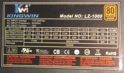

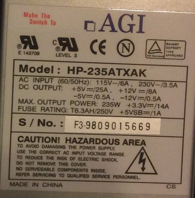

Reply 112 of 123, by FFXIhealer
Well, having just seen Phil's Computer Lab video of Athlon systems and the 5v rail (SEEN HERE), I decided to give you guys the PSU information. I JUST tried that x700 GPU in the system with EVERYTHING unplugged except one stick of DDR-400 RAM. That means I unplugged the HDD, Zip drive, DVD-RW drive, both intake and exhaust fans, and even pulled 1 of my RAM sticks, the sound card, USB card, and network card. What we are left with is JUST the Abit KX7-333 motherboard, the AMD Athlon XP 3200+ Barton CPU, 1GB of DDR-400 (single stick), and the ATI Radeon x700 AGP card. It failed to POST with all three PSUs. Here they are for you to look at.

An older PSU that used to run the Athlon XP system back in 2003 - plan to use it on my P54c 200MHz Retro gaming system

My 2010 Kingwin 1000-watt PSU that powered my GTX 480 SLI rig on an i7-860 for 6 years
144.01 KiB
1866 views
Looks like I have 125 watts available on the +5v rail for both the Cooler Master and the older PSU, and a whopping 150 watts on the Kingwin PSU. I'm not counting the extra 25 Watts on the +5VSB there, because I don't know what that is.
Anyone thing I'm not feeding the system enough power to run the x700 with this? Phil?
