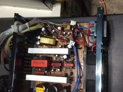

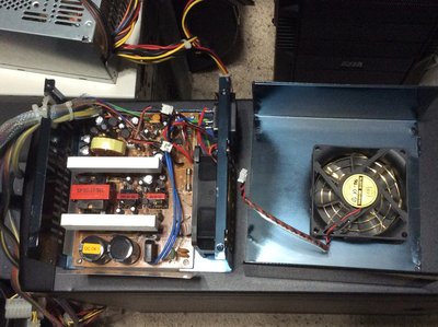

Reply 123 of 123, by FFXIhealer
I've already opened up this JPC-450DF-12V and found a few bulging caps. I will probably replace them and fix the PSU up so it's basically brand-new.
1.25 MiB
313 views
Bulging caps
1.25 MiB
313 views
Full PSU open
