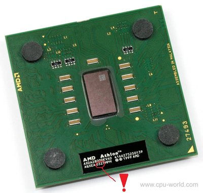

Reply 66 of 123, by melbar
Rhuwyn wrote:
You could also find an unlocked Barton and simply run it the same clockspeed as a 3200+ or even possibly higher.
For that, he needs to get an early Barton.
If the manufacturing date after 43 calender week of 2003, it shall be locked.
@FFXIhealer
Try to get an Barton with manufacturing date < 43 calender week of 2003.
Example picture:
This 2800+ is from 27 week , year 2003

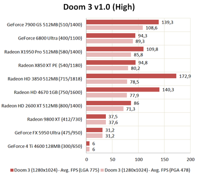

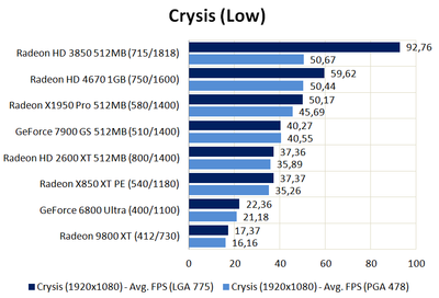

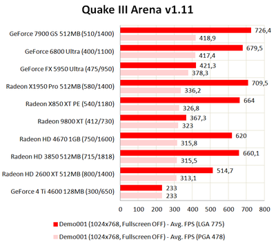

Reply 73 of 123, by agent_x007
All-in-Wonder are OK, but they are bound to be a bit hotter since there is more things on PCB.
Are those "GOps/s" you write about simple multiplications (ROP/TMU and Pixel/Vertex by clocks) ?
Because those are really not good way to do this...
Theory :
Radeon X850 XT PE (540/1180) [AGP] vs. GeForce 6800 Ultra (400/1100) [AGP] :
They both have 16PS's, 6VS's, 16TMU's and 16ROP's, so by Your math :
x850 XT PE should be better by at least VRAM speed difference (~7%), and by GPU clock difference in best case scenario (that's 35%).
Guess what ?
It's never that easy 😀
Reality (with few additional GPU's) :
35.37 KiB
1278 views
33.46 KiB
1278 views
26.85 KiB
1278 views
LGA 775 system is 4GHz Pentium Dual-Core E5700 (platform SS : LINK).
PGA 478 is Pentium 4 Extreme Edition 3,2GHz OC'ed to 3,5GHz (platform SS : LINK).

Nice charts. Looks like on those systems, everything UP TO the 9800xt cards were GPU limited and the CPU increase in performance did nothing, but then as the cards got a lot faster, the difference in CPU performance really starts to show between the (relatively) crappy Pentium 4 and the much nicer Pentium Dual-core. That right there is the reason I stay away from Pentium 4 systems. They almost universally run hot and are very inefficient with a stupid-long instruction pipeline. No wonder AMD Athlon chips beat the crap out of P4s clock-for-clock back in the day. And no wonder my laptop's Pentium M (runs at 2.1 GHz and runs circles around a 3.4GHz or faster P4).

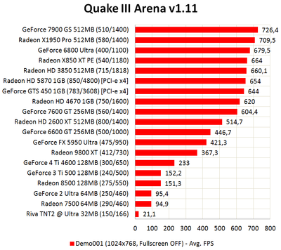

Reply 76 of 123, by agent_x007
@up Thanks, I have every result in screen shot form if anyone is interested 😀
I think "Ops" term (like FLOPS), is oversimplification to the point of it being 99% meaningless.
Why ?
Because those numbers have very little in common with real performance you actually see playing games or using programs.
Here's another chart (done on PDC 4GHz) :
52.83 KiB
1274 views
^That is the reason why I think you should rely more on comparisons made in actual games you want to play.

those are interesting numbers, but I would mention that, OpenGL and id games were an Nvidia specialty at that time, and that I'm not sure that Crysis low is running the same on an" SM3.0" card and an "SM2.0" card and could be a reason for the difference (no reason for the 9800XT to be this close to the 6800U if that's not the case)

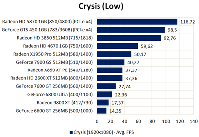

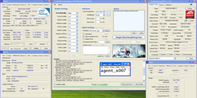

Reply 78 of 123, by agent_x007
Doom 3 is a Nvidia game - 100% true.
31.24 KiB
1249 views

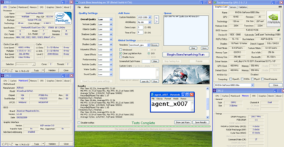

As for Crysis - belive me, I know it should score more - but it just won't.
Maybe it's SM2.0/SM3.0 but 7000 series are not affected as much by this (and all NV cards utilise the same driver).
9800 XT :
280.46 KiB
1249 views

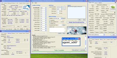

6800 Ultra :
311.48 KiB
1249 views

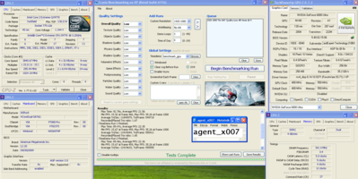

I redo this test with A LOT more powerfull CPU :
276.72 KiB
1249 views
Still "no go" : 22,36FPS (Avg.)
Score for lower resolution (1280:1024) on 6800 Ultra : 37,37FPS
302.29 KiB
1249 views
My "best guess" for what's going on here is either a crappy Pixel Shader (since it was redone in G70), or ROP/TMU bottleneck somewhere (maybe bad use of memory bandwidth on NV40 part ?).
In short : Radeon 9800 XT is simply more efficient with code that Crysis uses.
