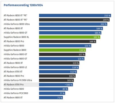

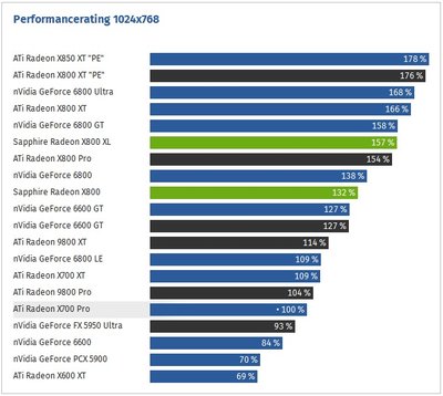

Reply 87 of 123, by melbar
3DMark 03 Version 340
3DMark 05
AquaMark 3
Far Cry V 1.2
Unreal Tournament 2004
RtCW - Enemy Territory
Tomb Raider - Angel of Darkness
Half-Life 2 (Counter-Strike: Source, Build 2124)
Doom 3
    102.22 KiB
    1493 views
    Rating 1280x1024
    95.62 KiB
    1494 views
    Rating 1024x768

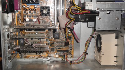

Reply 88 of 123, by FFXIhealer
Well this is interesting.
In attempting some cable management on this system, I moved the ZIP 250 drive from the Master position on the Primary IDE port (jumpered as slave) to the slave position of the Secondary IDE port. I moved the Primary IDE port position to the 80GB WD hard drive, which had been occupying the Slave position on the Primary IDE port. It used to look like this:
Primary IDE Master: WD800JB-00FMA0 (On Gray Slave slot on cable)
Primary IDE Slave: IOMEGA ZIP 250MB (On Black Master slot on cable)
Secondary IDE Master: Sony DVD-RW DRU-10A (On Black Master slot on cable)
Secondary IDE Slave: None (empty Gray Slave slot)
Moved everything to this:
Primary IDE Master: WD800JB-00FMA0 (On BLACK MASTER slot on cable)
Primary IDE Slave: None (empty Gray Slave slot)
Secondary IDE Slave: IOMEGA ZIP 250MB (On Gray Slave slot on cable)
The system takes over 10x as long to POST and won't boot. Went into BIOS and did an Auto-detect on the Primary IDE Master and got a bunch of zeros.
Moved the drives back to their original configuration and BOOM, I get into Windows XP no problem.
What the hell is going on here? Is the HDD so old and used that it no longer can run control of an IDE cable as the Master unless it's handed off from the "slave" of another drive? I'm about to attempt a CMOS reset with the 2nd drive configuration to see.
Why would I want to change it? Well, the system has a spot for a 2nd hard drive next to the first and I had thought about putting in a larger 120GB hard drive at some point, or even moving the OS over to that one with migration software. I don't know yet. But I was going to have the slave spot on that IDE ribbon available right there while I was doing cable management and cleaning up all the dangling wires/cables.
UPDATE: Sorry, my bad. I got it working the 2nd way by re-jumpering the HDD to Cable Select. Works fine.

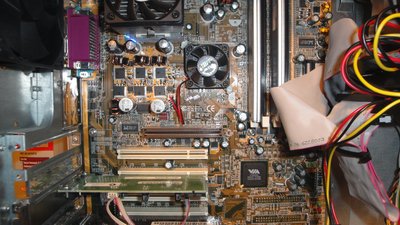

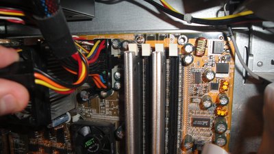

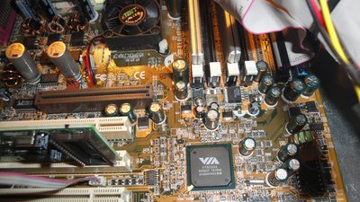

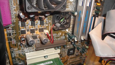

Reply 89 of 123, by FFXIhealer

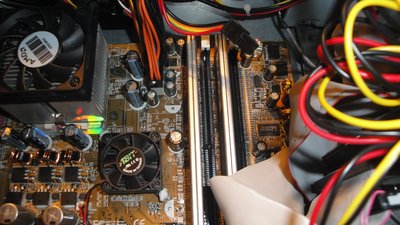

Ok, as was pointed out to me on Facebook, it might be a concern that this Abit motherboard needs expert eyes-on. So I'm adding the photos here on this thread for you guys. Examine the condition of the MB capacitors and tell me what you think. If I need to do a re-cap, please be helpful and add manufacturer brand-names and sites to order from (keep in mind I live in the U.S.A.)
4.5 MiB
1474 views
4.5 MiB
1474 views
4.43 MiB
1474 views

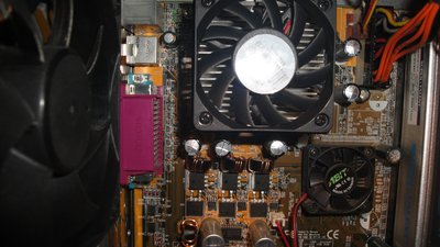

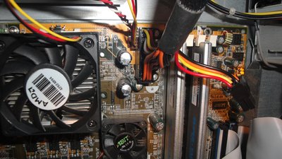

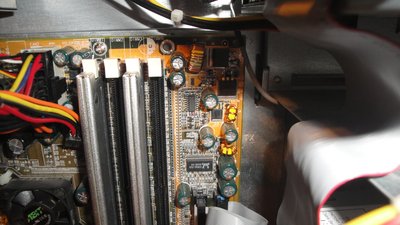

Reply 90 of 123, by FFXIhealer
4.27 MiB
1473 views
4.27 MiB
1473 views
4.34 MiB
1473 views
4.2 MiB
1473 views
4.29 MiB
1473 views
Reply 91 of 123, by KT7AGuy
There are several swollen and at least one leaking/venting cap. My advice is to have the entire board recapped if you want to use it for a good long time. I'm sorry that I can't offer more help; I'm just not that skilled with soldering or identifying which caps to replace with what. The folks over at BadCaps.net are the experts. You should post these photos over there and ask for advice. The owner of BadCaps.net also offers a re-capping service. It's not cheap, but he does very good work and it is worth the price. He's done several of my boards and they've all come back in perfect working order.

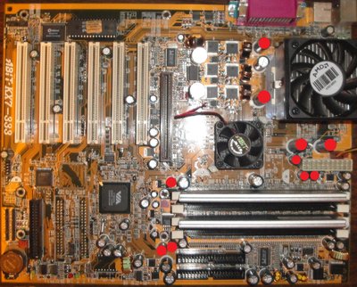

Reply 92 of 123, by FFXIhealer

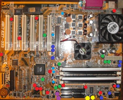

Yeah, I took another shot and then edited it twice. Total Capacitor List:
2x Nichicon 4700 HD 6.3v H0147 BROWN
5x Nichicon 3300uF 6.3v (Tall Black near CPU)
2x Teapo 2200uF 6.3v GRAY
2 x Teapo 1000uF 16v YELLOW
14 x Teapo 1000uF 10v RED
8 x Teapo 1500uF 6.3v BLUE
8 x Teapo 1000uF 6.3v GREEN
2 x Teapo 470uF 6.3v PURPLE
5 x Teapo 100uF 16v CYAN
1.74 MiB
1458 views
Color map of each type of capacitor and their locations
1.77 MiB
1458 views
Mapping of bulging and leaking capacitors

Reply 94 of 123, by melbar
I think you've forgot to mark the middle capacitor direct left to the CPU.
Anyway, it's a nice board which should be worth to spend time and/or money for it (re-capping).
I've already started to solder out the bad cap's from several boards i have.
Status is now:
>20 capacitors are desoldered from 3 boards (one Abit, one MSI and this Epox one).
Worst problems:
3 times, the pin's were not able to solder of the boards and part of the pin's just break from the cylindrical capacitor.
Then i had to drill out these damned fixed holes with the thinnest drill tool i have.
I hope, after i'll get the new capacitors, the "solder-in" work is not that "pain in the ass" like the 3 times i've mentioned before...
Reply 95 of 123, by FFXIhealer
I did not forget to mark anything. If you check the caption on that photo, you'll see that I only marked caps that had any kind of detectable leakage or actual bulging on the top. That one is completely clean and completely flat on top.
Then again, if I re-cap, I'll replace ALL of the capacitors - not just the obviously damaged ones.
