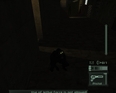

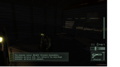

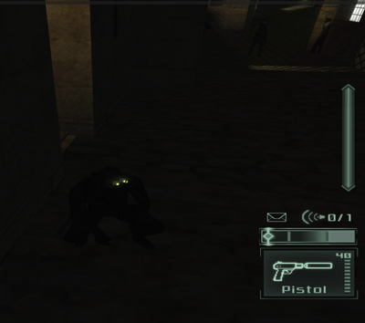

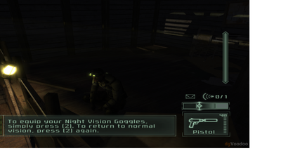

Reply 127 of 234, by hishamerrish
Hi dege ....
there is an issue with the light rendering in SCPT in one place as far as i know
it is rendering fine with an old version only (d3d8_0_05)
I tried many version of djvoodoo2 but no luck
if it is possible to be fixed that will be great
and the bloom is not broken in the old version
thanks a lot 😀
dgvoodo2 2.73 v
v d3d8_0_05
    1.77 MiB
    2017 views
    dgvoodo2 2.73
    506.46 KiB
    2017 views
    v d3d8_0_05

I confirm that the light,coming out the door, is not visible as it shoud be in that area. I even checked my old videos capture. It seems there are still some small issues with the light and shadows.
That is the Israel level , near the start of the mission, first corner to the left.
@hishamerrish
Try and older version pre dx9-dx11 era 😀 Is it the same?

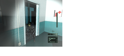

Oh my GOD you really know this game 😀
i tried evrey version of dx8
the only one has the light visible is http://www.jiri-dvorak.cz/scellpt/index.html
the force res in djvoodoo 2 not working on this on only the ThirteenAG widescreen fix works fine
i have no ide about the older version pre dx9-dx11 era !!
could you gave me info
    355.48 KiB
    1886 views
    the light rendering difference here

Try 2.54 .
The guy that did the original implementation was an active user here, Komat(the url posted by you is his) i think. He was the first who created a working versions and release the source code. Fans here(lowenz and me and some other few) gave Dege directions towards Komat work. Dege then fixed some issues with komat versions and fixed/enabled some other good stuff related to the game. So Komat versiosn is inferior to what dgvoodoo does. Old SC games require specific fixes which cant be present on a generic wrapper but this doesnt mean the wrapper is perfect. 😁
Yeah bloom is missing/flickering or its very small. Same for heat haze.
Color of the light still wrong in some areas.
But hey, look at the good side, it's free and close to the original. Future developements might fix the issues. And i 'm still very grateful. SC reminds of my childhood and some lost friends.
If you want the best experince get xbox one x and get the OG xbox discs(double agent is event better than the PC/360 versions). The ports are rendered to 4k without any issues.

i tried th 2.54 v its better than the rest of all ver ... you need to copy the dgVoodooCpl.exe to the game system and use the DX8.0 that come with the 2.54 ... it will make the bloom better
and the shadow res only render with dgVoodoo force res and the WidescreenFix dose not render the shadow
here two images one with dgVoodoo force res and the other with WidescreenFix both of them 1080p
    1.09 MiB

@Dege here how the bloom looks with 2.54, forced res to 4K. Still pixelated but not shifted which it makes harder to spot:
2.54
2.7x
So over time it got worse. (that why i decided to create this thread for SC before the move to higher dx api's. 😁.New things break old things. One of the rules of development.). When you have the time maybe you can have a look why it happens!
Maybe we you can limit the bloom or avoid to apply the resolution like it happens(i tihnk) for the heat haze.
Not sure how these things works(this is an wrapper) but for example in emulators world, there are settings like a resolution scale threshold, where certain things are not 'enhanced'. Just trying to give you an ideea.
There might be games out there which have the same issues, even in DX 9 era. A slider/or range of values should be as options to be able to be set per user desire.
