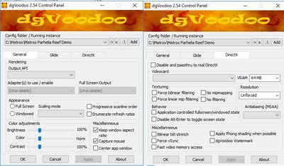

Dege wrote:
OK, here is the updated WIP, 32.1: 😀
http://dege.fw.hu/temp/dgVoodooWIP32_1.zip
The included controlpanel (and the previous one) looks like this to me:
99.45 KiB
3025 views
This seems to be caused by corruption of the conf file because if I delete it all options are available again. However if I change settings, thereby creating a new conf, the problem returns.
PS: Wouldn't it make sense to make the hardware id adjustable by the user, like in 3DAnalyze, for similar cases?
Edit: This is my conf file.
    dgVoodoo.conf
    133 Bytes
    114 downloads
Reply 101 of 1111, by Dege
Thanks!
This bug comes when a config file is found in the CPL folder but the CPL folder itself isn't yet in the folder list... 😊
I fixed it, reuploaded WIP32.1, changed only the CPL app.
Please download it again.
