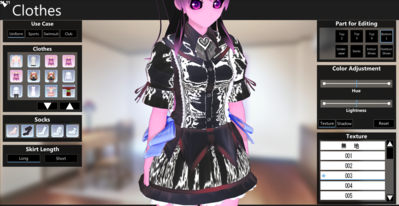

Arkblade wrote:
when using any cloth with user textures, it will cause bad texture noise. it affected of hue slider on cloth settings.
this texture noise problem, also it happen in another user.
It seems that this problem is not caused by a specific environment.
The attachment unknown.png is no longer available
dege, if you need to check this bug. use this files.
The attachment sitagi00.7z is no longer available
just extract inside *.bmp's to AA2's "data\texture\sitagi00" foldier.
it will be show your cloth change screen of under "underware" texture section.(you can go that from aa2play's class screen)
Reply 1102 of 1111, by Dege
Arkblade,
thx for your feedback. Unfortunately I didn't have yet time to look into the problems, but I'm going to.
And for the time being, I'm planning to release a separate version for this game until I merge that into 'main' dgVoodoo.

Reply 1105 of 1111, by Arkblade
Dege wrote:
Arkblade,
I really appreciate it from the bottom of my heart. I am looking forward to the release of a next bug fix version.

Reply 1107 of 1111, by aaudev
AAUnlimited dev here. Thank you for creating the alternative dll that works with AA2. Many of us have the same issue with textures that Arkblade reported above, myself included. I want to notify you that I intend to make a release of our mod software with your dll included, renamed to "dgd3d9.dll". You can see our homepage at https://github.com/aa2g/AA2Unlimited
