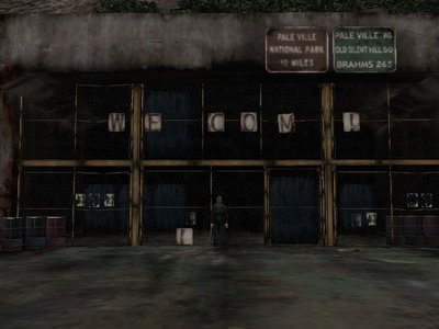

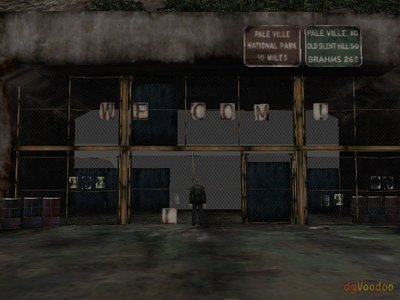

Dege: Reading the issue tracker, apparently dgVoodoo2 has a problem with Silent Hill 2. If you exit the initial room you're in and go left to the abandoned tunnel dgVoodoo2 gives you this:
70.9 KiB
1377 views
It's also a problem with Nvidia native D3D8 rendering, but not AMD or WineD3D (shown here):
71.05 KiB
1377 views
Reply 469 of 1111, by Dege
Thanks for that!
I've "fixed" it. Quotation marks are because this "white shader" problem is not really a (driver) bug but it's about different behaviors of different implementations (nVidia, AMD, dgVoodoo 😀 ) for an undefined texture sampling situation in old DX.
