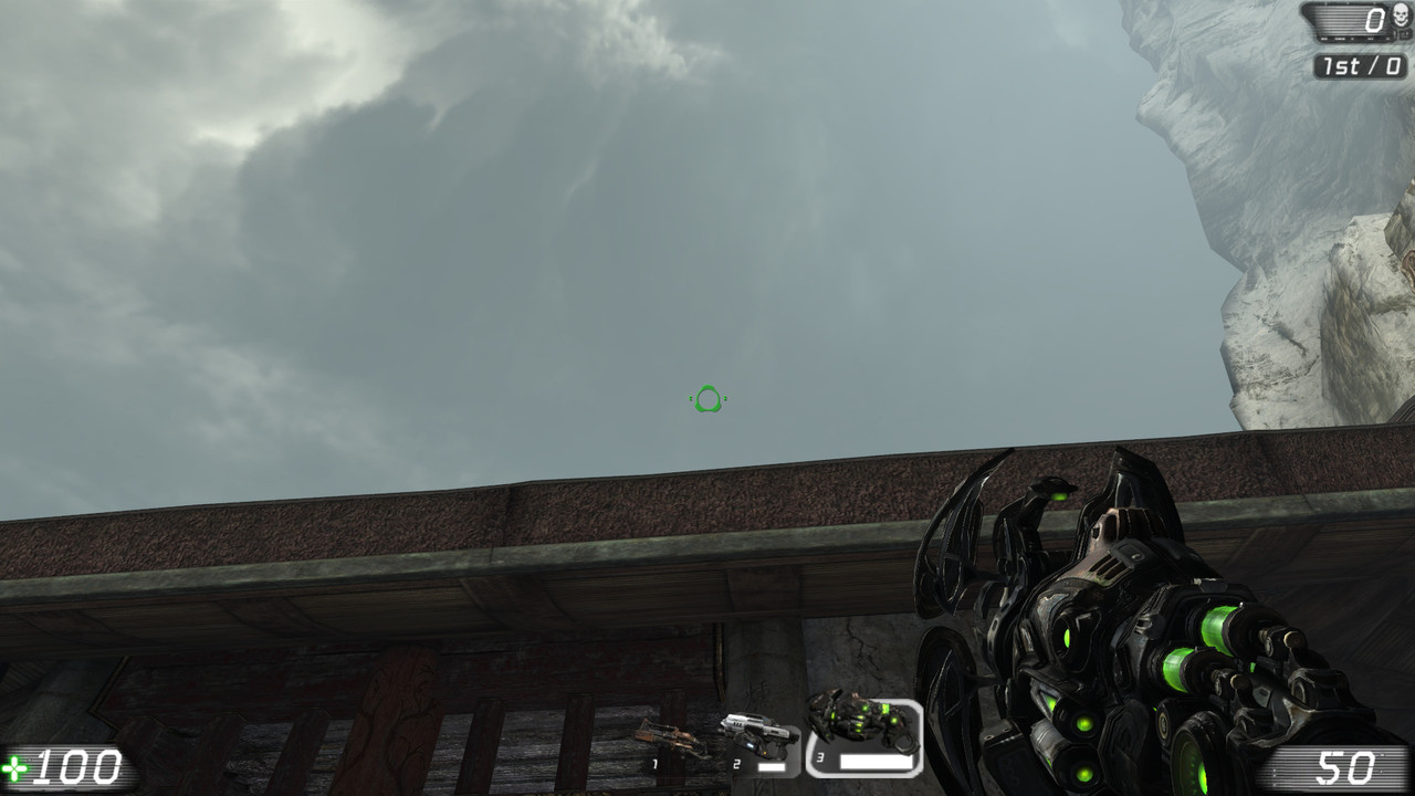

Reply 855 of 1111, by ZellSF
DuckTales Remastered
Strania - The Stella Machine
Both don't render anything (just black screen). Pretty new games so might both need some feature dgVoodoo doesn't support.
Dragon Age: Origins
Medium quality lightning is obviously wrong.
81.48 KiB
1906 views
