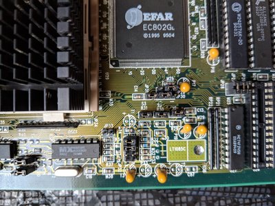

I am working on G486-evb with a am486 dx4-100 as you can tell by the title.
The cpu says its a 3 volt processeser but the only way i can get it to post is setting the board to 5v.
after further inspection, the jumper settings for voltage list 5v and 3.3v but everything connected to the jumpers for 3.3v are not populated...
When I turn on the board it lists the cpu as a dx2 100 no matter what jumper settings i change.
I'm Going to go under the assumption that I should not run the cpu at 5v for the risk of destroying the cpu.
That being said I also assume I should buy a new board if I want to run a 486 dx4-100 as all of them i have seen are 3.3v..
any thoughts will be helpful!

DX2-66 vere the last chips without voltage markings on them (so 5V). Your BIOS likely does not know about DX4, that's why it's 3V section is not pupulated (voltage regulator should be missing as well).
Yes, you should hunt for a later board.

I am pretty decent at electronics and had a crazy thought of populating the voltage regulator and the missing components around it.
Eh its probably not a good idea as I would not want to take the chance and mess up a working board.

Ya I have been staring at the board and I think All i need is a 3.3 fixed voltage reg and a 22uf tantalum cap for voltage smoothing.
I think I am going to pull the trigger and order the parts through digikey after looking at data sheets and tracing out the voltage circuit I'm pretty confident.

Just an update, I ordered the 3.3v reg and the 22uf cap it was outputting 4v for some odd reason.
I looked over the area and found two unpopulated resistor spots and it made me think I should have got an adjustable regulator not a fixed, so i tried a 5k ohm trimmer in that spot adjusted it and It is now reading 3.3141
Then I removed the trimmer checked the ohms and it was .014, So I grabbed a 0 ohm resistor dropped it in and were all good!! 3.3v for my cpu!

Hey GoXod, any chance you could posts pics and a bit further explanation? I have the exact same 486 board and I was trying to get a 486DX4 100 working in it just like you. I didn't have one when I was a kid, but when I was still running a 386DX 33, I remember thinking that a 486DX4 100 must be SO FAST. When I got it, the board came with a 486DX2 66, but I knew I had to upgrade to the 486DX4 100.
I am not an electrical engineer. I do not know how to do circuit design. That being said, I know what a voltage regulator is and does. I know what tantalum caps are. I have recapped a number of game consoles successfully, so I'm hoping I can handle this.
I see there are a few spots where tantalum caps are missing, T1, T2 and P23. I see the open spot for a LT1085C voltage regulator. And I see the spot C97 where I'm guessing maybe you dropped in the 0 ohm resistor. Where did you install the tantalum cap? I'm guessing T2. And you mentioned you should have bought an adjustable regulator, but then with the 0 ohm resistor the voltage was outputting 3.3V as intended. Would you be willing to provide a recommended parts list?
One last question, where were you measuring to find the output was 4V rather than the expected 3.3V?
