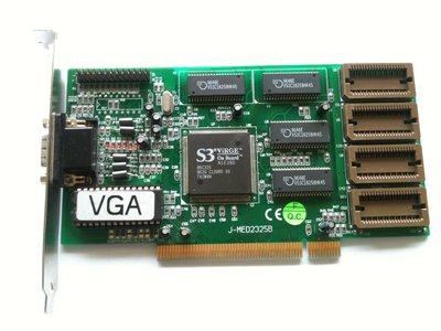

I also have a Number nine reality 332 Virge 325,nice little card, it's installed in my Cyrix 5x86 100 Windows 95 system. It's a good bit faster than my generic virge 325, image quality is far better too, blacks are black unlike many other Virge 325 cards. Here is a pic of the generic one.

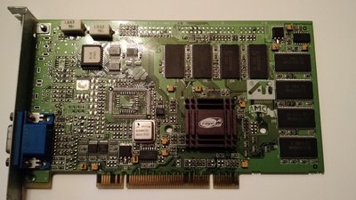

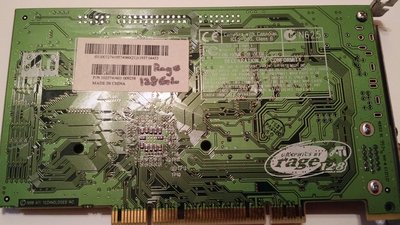

How do you tell the difference by visual inspection if the ATI Rage 128 GL is for Mac or PC? I almost never see anyone with the PC version of the 128 GL PCI. What does that sticker on the BIOS say? Is that what gives it away?
Reply 31 of 46, by clueless1
Honestly, when I found this card, I had no idea there was also a Mac version. So I'm not sure how to tell the difference. But here are a couple of photos that may help you.

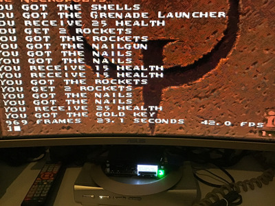

I bought me a Hercules Stingray 64 with ARK2000PV based on the tests here. Its the 2MB Version and i run it with the latest P200 MMX.
I also did a quick quake bench on VGA with result of 42.0 FPS. Very happy with the GPU, many thanks for your testing guys!
That's a bit too slow even with sound. Which motherboard?
Reply 37 of 46, by Jackhead
really? Here is my MB: https://stason.org/TULARC/pc/motherboards/A/A … um-MS-5146.html
i used the quake 640x480 bench from dosbench (so without sound). But after the bench i checked the resolution of the demo in the options and it say 320x200. What is the best way to do a quake bench? is there a console command or something?

Ah, SIS boards. Then it's correct probably, they're slower than Intel.
Timedemo demo1
