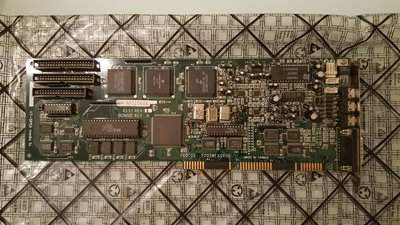

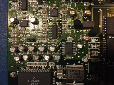

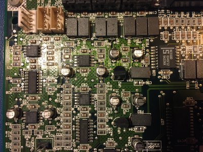

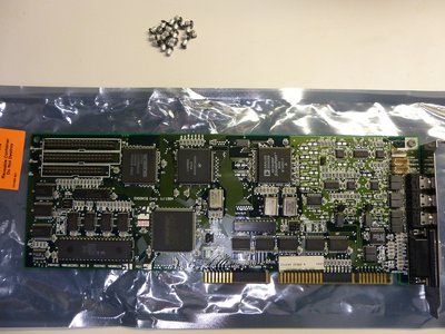

I just received an Ensoniq Soundscape S-2000 I won on eBay, and unfortunately it's suffering from a case of leaking capacitors. It seems to work just fine but has rather weak audio output with a little bit of distortion, especially one of the channels. I suspect the capacitors just recently begun to break down because the board was actually still wet with electrolyte in the vicinity of the large arrangement of caps just next to the codec. After cleaning up the mess, several of the capacitors had dulled solder joints from the corrosion that was just starting to occur. The PCB itself seems unscathed though, so I think I caught this one early!

I've already ordered replacement Nichicon UUQ series capacitors which are physically an exact match, and being designed for audio equipment should be a good fit for such a nice old sound card. I don't normally buy into the "audio" capacitor snake-oil, but the cost difference was minimal...so why not?
While I wait for the new caps to arrive, the old ones have been removed and the board thoroughly cleaned.

I'd like to note that I've recently begun to amass a small collection of the various Soundscape versions (S-2000, Soundscape-II, OPUS, NEC Harmony, VIVO 90, SPEA Media FX) and this is the first to show any signs of capacitor failures. Anyone who has one of these boards may want to consider taking a look to make sure the capacitors haven't started leaking.
I'll be sure to follow-up with the results once the replacement caps arrive!

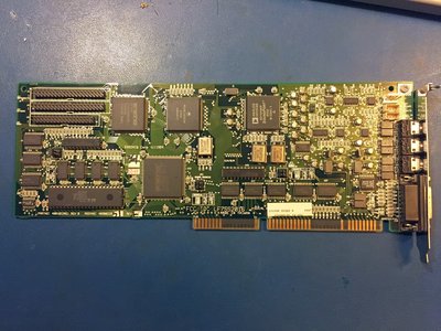

Reply 1 of 46, by FesterBlatz

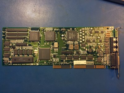

The new capacitors are installed and the Soundscape looks and works like new again.

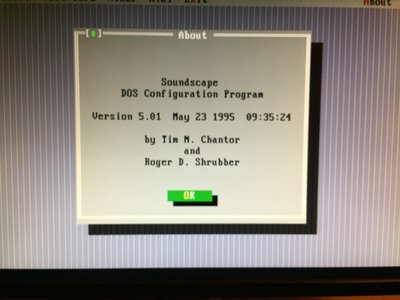

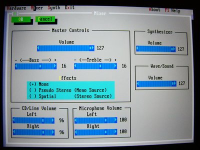

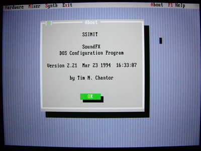

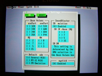

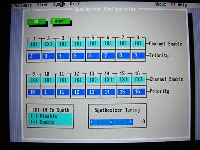

In the meantime, here are some photos of the version of SSINIT that comes with it:

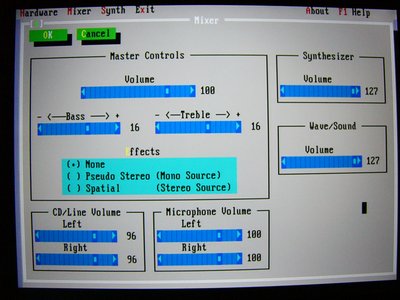

Reply 10 of 46, by boxpressed
It looks like I put up two shots of the same screen. The missing screen is interesting because it lets you choose MT-32, GM, and SB mode. When you select MT-32, the program loads a series of patches. I don't remember seeing another version of SSINIT do this. I would have to switch into MT-32 mode by running a separate program from the DOS prompt.

I just realized I never followed up with the driver version I'm using on my S-2000. I was just playing some Elder Scolls Arena on my 486 so I quick dropped out of it and grabbed a picture...
SSINIT reports as version 5.01. The SNDSCAPE.COD files are all dated 05-04-1995 but I'm not sure if there's a way to find a specific version number for those.
The manual selection of modes is something that Ensoniq changed between driver versions. My old manual shows those options. Then the addendum they once mailed me (with new driver floppies) writes about the newer way to choose modes. I actually mailed in a driver bug post card about the Star Trek Technical Manual causing a driver crash in Win 3.1 and they sent me the new driver floppies some time later. 😀

@swaaye: I don't suppose you'd happen to have an old set of S-2000 driver disks with a SSINIT that works this way for the S-2000?
When I tried boxpressed's SSINIT for the SPEA/Reveal on my S-2000, it complained the wave port was incorrect and wouldn't fully initialize the board. I assume it's expecting to initialize a CS4248 codec instead of the AD1848. Even though the two are essentially pin-compatible, their configuration registers are handled a little differently and one must be set to emulate the other. Since the Reveal/SPEA clones were apparently based upon Ensoniq's earliest reference design, I have a hunch boxpressed's SSINIT may actually predate the S-2000.

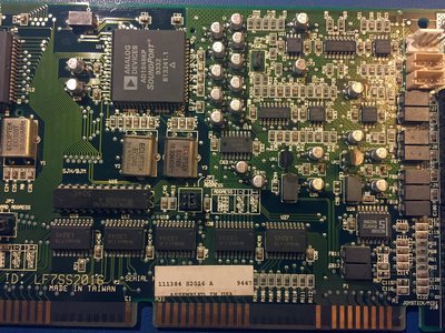

Reply 15 of 46, by Predator99
As there seem to be some experts here I take the chance to raise a question 😀

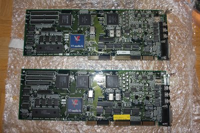

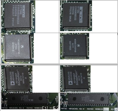

I own two of the V7-media fx clones. One of them (on the top) is working perfectly. The other one (bottom) is not recognized at all. I tried several jumper settings and driver revisions without success.
Both cards are in perfect condition and they do not seem to be damaged in any way.
As there are minor differences in the chips on the boards...do you think it is possible they require different driver revisions? Maybe I have not found the correct revision for the dead card yet? Would be my last hope to get this working...

Reply 16 of 46, by FesterBlatz
@Predator99: Both of those boards were referred to in driver documentations as SPEA's "Type 2" Sound FX board and except for the sticker should be pretty much identical to an S-2000. At some point SPEA switched from selling Ensoniq's old reference design (referred to as "Type 1", and identical to the Reveal SC600) to re-branded retail S-2000s. The difference in chip revisions you noted are cosmetic and appear to merely be different date and lot codes.
You should be able to use any of the Ensoniq Soundscape S-2000/Soundscape-II/Elite driver bundles with these boards, so if one is working for you and the other isn't, I'm afraid it does seem like you have a defective board. 🙁

I think you are in luck.
I have a Gateway 2000 CD from 1994 that has some old S-2000 drivers for Windows 3.1 and DOS, version v1.03.05. They should have the old functionality.
