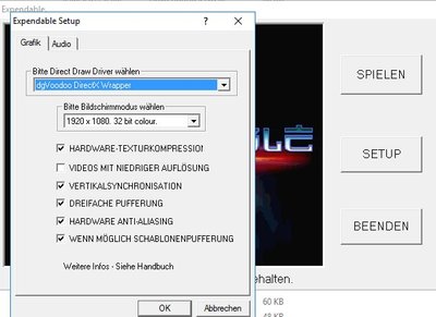

Expandable's configuration program needs compatibility mode with dgVoodoo 2 (not natively, weirdly enough)

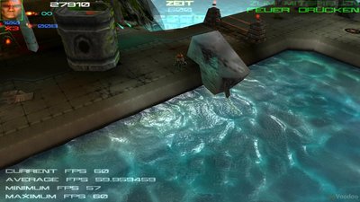

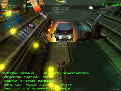

Reply 1 of 6, by teleguy
Works for me.

Reply 2 of 6, by ZellSF
teleguy wrote:
Works for me.
Weird it works for me too today. It didn't yesterday and I can't remember changing any settings.
Configuration program seems to need compatibility mode for me with dgVoodoo2, but it doesn't natively.
Reply 3 of 6, by ZellSF
Oh it's one of these few games who won't try to work if the VRAM reported is too low for the display resolution. That's what I did wrong, not being able to test with the config program when dgVoodoo2 was used...
