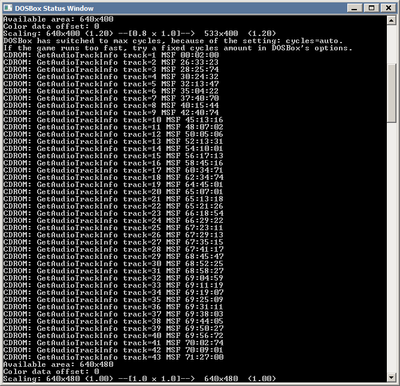

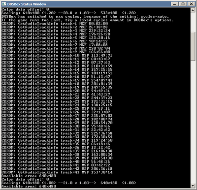

You are talking about this patch, right? AUDIO Patch supporting FLAC, Opus, and MP3 audio tracks
If I understand correctly, this patch is not incorporated into the DOSBox ECE (yet)?
The latest version of the DOSBox ECE when using the ISO/WAV/CUE format shows these strange numbers:
51.06 KiB
1247 views
While using the ISO/OGG/CUE format all looks correct:
50.68 KiB
1247 views

Reply 483 of 1369, by krcroft
Yes to both.
AlexRK wrote:
The latest version of the DOSBox ECE when using the ISO/WAV/CUE format shows these strange numbers: […]
51.06 KiB
1240 views
50.68 KiB
1240 views
Those WAV/CUE track start times (Minute-Second-Frame, or MSF values) look invalid: typical CDROMs are 70 minutes yet you've got 'M' (minute) values exceeding 200 minutes. No fault of your own.. the code is just broken.
As for the OGG/CUE MSF values: although these are sane and valid (and more than likely happily accepted by your game), I anticipate the OGG/CUE MSFs still won't match the MSFs reported if you mount a BIN/CUE (which for a perfect CDROM dump, will match those of the physical CDROM tracks). Then again, exact or "correct" MSF's are more of a curiosity than a necessity though; I'm only aware that Destruction Derby requires MSFs that match the CDROM.
