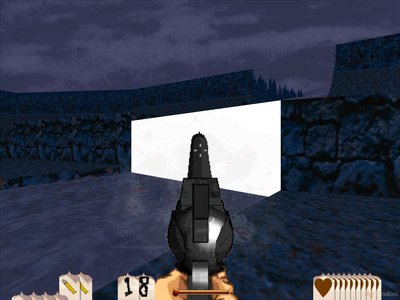

No longer seems to drop inputs, but something is still a bit off, but not sure if it's the game or dgVoodoo2, will try to figure it out a bit later, but a new problem:
340.9 KiB
3987 views
That river is supposed to be less white. Attached a save game, though you can just type "olscore" until you get to the fifth level. Walk close and you'll see it, far away it will be fine.

Reply 8 of 27, by Dege
Yes, indeed, I checked it.
Whiteness is position and view angle dependent though, I can position myself to get the waterfall to appear as it should.
Glide renderer is OK.
I'll check the reason later.
Reply 9 of 27, by Dege
The game creates 2 textures for the waterfall and one of them is released right after it created and loaded with bitmap data.
Later, when choosing which one to render, the texture is not found by its associated texture handle, so whiteness is symptom of a missing texture.
It very seems to be an Outlaws-D3D renderer bug. BTW, I never thought that D3D renderer of Outlaws is D3D2. Good old execute buffers... 😁

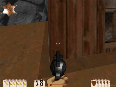

The Glide render actually supports 800x600, if you set it in the registry, but it's not enough to avoid glitches like this:

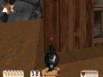

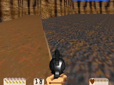

Some better comparisons on forced dgVoodoo2 resolution vs higher internal Outlaws resolution:
206.75 KiB
3606 views
219.68 KiB
3606 views
