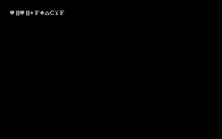

Reply 23 of 55, by superfury
Well, for some reason, Megarace on AT 386 now crashes with strange output:
7.9 KiB
1324 views
Megarace displaying strange characters on the screen?
The Diagnostics port has the value 1D for some strange reason? Is it trying to enter Protected Mode and failing for some reason?
Also, the AT BIOS gives a "102-System board error" before booting, for some unknown reason(is essentially a 386 running at 286 speeds @6MHz)?
Also, Windows 95 setup simply hangs still, just like before.
The SuperSoft AT BIOS now doesn't display an INT#XX anymore in the bottom left corner, but does beep and show the old error 1 on the protected mode test(6 beeps, 1 beep)?
