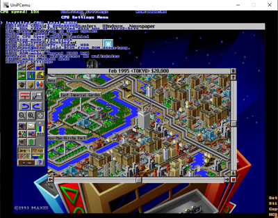

Of course, having all that working I had to try:
541.39 KiB
868 views
UniPCemu running Inboard 386/PC on it's XT with ET4000/W32 SC15025 graphics.
GPL-2.0-or-later
Of course, with all caches in the driver enabled for maximum speed (INBRDPC.SYS using EGA and BIOS ROM shadowing with fastest CPU speed setting (though it has no effect in IPS clocking mode, it will have effect on cycle-accurate mode)).
It seems to complain about some sound driver dll not loading when starting the app, but the Adlib sound works without issues?
Keyboard and mouse(with mouse.com loaded) run fine as well.
Plain vanilla Doom seems to run somewhat, until the main menu. Then it doesn't seem to respond to key inputs?

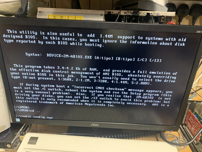

Reply 49 of 55, by Mike1978
superfury wrote on 2023-03-05, 14:02:
Of course, having all that working I had to try: […]
I see the same behaviour with doom on actual hardware and fastdoom, I assumed we’re hitting the keyboard issue we see in other software. Is this the a20 gate at play? Similar behaviour observed with attempting to run the AT version of the bios extender to add a FDD drive 2M-ABIOS but if you add INT13 to the command line the keyboard isn’t lost (but bios extender still fails as meant for an AT class machine).
1.46 MiB
816 views
2m-abios
Not sure if it’s this same CMOS checksum causing issues mentioned here?
Similar again if you attempt an upgrade from Win 3.1 (using the intel 3.0 inboard drivers) to Win 3.11 it works with mouse but not keyboard. This is the keyboard issue we seem to experience in all these instances. Would be good to understand it further.
It’s one of the blockers to go beyond 3.1
I’m guessing the software is expecting something AT like but it’s not present on the XT with the inboard.
This is why I was exploring the stuff from Al Williams and the nuances of the inboard differences.
Be good to crack that one!
