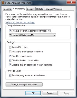

Which Windows version are you using? The game works flawless for me without the need for dgVoodoo in Windows 7 64. I did have to use the replacement installer found on this website:
http://www.play-old-pc-games.com/2014/05/23/future-cop-lapd/
I also used the Windows 98 compatibility mode for the exe. All option screens, startup, mouse, etc. works perfect.

Well Windows 7 is the latest OS to support "natively" the game with W98 option, I don't remember being able to play it on Windows 8 also.
But huge thanks for the tip, mixing W98 mode + dgvoodoo2 fix a lot of issues on Windows 10 including the window popup and the music is properly played, also graphics are native !
Thanks again 😉
However the game only run in English edition, my french CD isn't compatible at all, the game crashs after intro no matter what but I patched the US release with french audio easily.

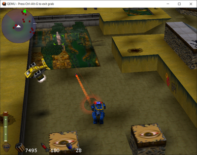

Works fine on QEMU 3Dfx in Windows 10 x64 with Win98SE guest. Just do not run the 3D card detection and modify the registry directly to select "voodoo". The version support high resolution rendering at 1024x768. Never had a PSX myself but I don't think PSX version would support that. I always prefer PC port of 3Dfx games, especially those with native 3Dfx Glide support.
1.46 MiB
3310 views
Future Corps QEMU 3Dfx Glide

UPD:I tried to start the game with QEMU 3Dfx. Alas, the game starts, but crashes in 10-15 secs, displaying the video with credits (
