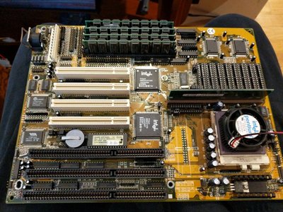

Reply 33 of 39, by oeuvre
Ordred an FIC PT-2003 or PT-2000 with a 133MHz Pentium in it. Cheapest working Socket 7 combo I found on eBay. Also got a Matrox Mystique 220 for it.
    355.95 KiB
    1065 views
Reply 34 of 39, by oeuvre
Got the motherboard in the mail today. It's an FIC PT-2003.
Pictures http://imgur.com/a/LUFcg
Came with 80MB RAM (2x32 + 2x8MB), a 256K COAST module, and a 133MHz Pentium processor. Had to replace the CMOS battery.
Fits into the case perfectly. Reused the ribbon cables that originally came with the GW2K. Using a DIAMOND STEALTH 3D 2000 pro 4MB PCI video card for now (ordered a Matrox Mystique, might use that instead when it comes). 3COM 3C905-TX PCI ethernet and a Yamaha YMF719 sound card. Replaced the proprietary 2X Sony CDROM drive with an IBM 40X CDROM drive. The hard drive is a 426MB Conner. Everything works fine! When I get home from work I'll get to installing MS-DOS + WfW 3.11
