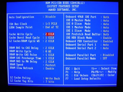

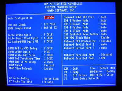

I have the Lucky Star LS486e Rev D mobo, which does take EDO ram, and remember that there is a setting in the bios that drastically reduces the memory speed as You
have shown in the first post.
Maybe try adjusting the L2 cache tag bit setting to 7 and see if that increases the speed.
I'll check with my motherboard tomorrow after work.

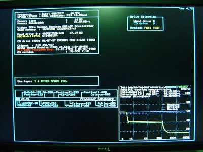

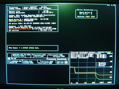

Reply 43 of 54, by Imperious
I tested speedsys memory speed with Cache tag bits at 7 then 8, here are the results.
    695.29 KiB
    1202 views
    769.48 KiB
    1202 views
    650.04 KiB
    1202 views
    757.06 KiB
    1202 views
Reply 44 of 54, by feipoa
I've always observed odd behavior if you do not set Write-back L2 cache to a 7-bit TAG and write-through L2 cache to an 8-bit TAG.
