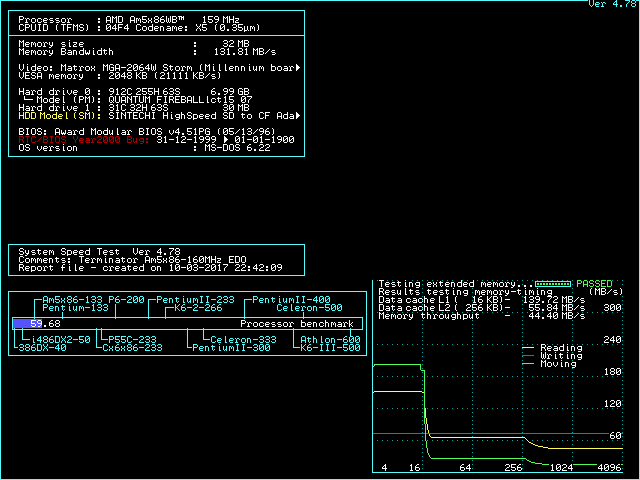

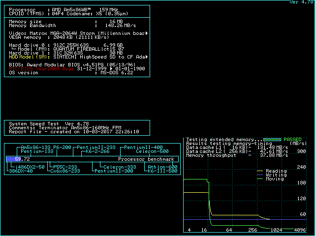

So over the weekend I did some benchmarks of the SMT Terminator with an Am5x86 at 160MHz (4x40MHz) using both EDO RAM and FPM.
Here's the Speedsys result with EDO RAM installed:
10.03 KiB
1355 views
And here's the FPM results:
10.04 KiB
1355 views
I also ran cachechk but I forgot to copy the txt files so I'll add them to this post later today.

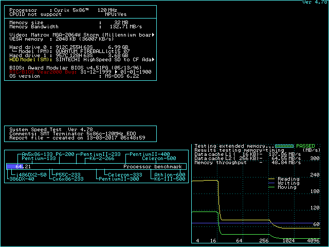

I also spent a lot of time using this board with one of my IBM 5x86c CPUs at 120MHz with EDO DRAM, and even with the lower clock it outperforms the AMD 5x86. In this case I did run a Quake timedemo, and with the Matrox Millennium installed I got 16.7 FPS.

Reply 27 of 54, by feipoa
It is interesting that the L1/L2/RAM throughputs with your ALI w/X5-160 aren't any better than that with a UMC 8881 board w/FPM. e.g.
ALI
L1: 140 MB/s
L2: 56 MB/s
RAM: 44 MB/s
UMC
L1: 141 MB/s
L2: 59 MB/s
RAM: 45 MB/s
So I wonder if your motherboard is interjecting some wait states with FPM then removing the wait states when EDO is installed.
Cyrix 5x86-120 and AMD Am5x86-160 are usually pretty close in performance. What are your results with Am5x86-160?
Sounds like they really cheaped out on the board components for the VRM. To make a compromise for 3.1 V (which is useless) just to save money on an extra resistor? I usually like to remove the 4V resistor to make variable output VRMs on board. This way, you keep the 3.45 V setting intact.

I had a little time yesterday to run some more tests with the ALi chipset using my new STB Nitro S3 ViRGE (feipoa: if you want a dump of the STB video BIOS for your Dell version let me know). I will say this, the STB Nitro picture quality on an LCD display is superb, perhaps rivaling even the mighty old Matrox Millennium I bought brand new in 1996. The Doom, Quake, and PC Player benchmark results are identical to the Matrox (and NVidia TNT) too.
For some reason I was unable to get my Am5x86-133 to run reliably at 160MHz, even though last week it did so without a hitch. I'm not exactly sure what the reason is, but I suspect it may be CPU voltage related since believe it or not when overclocked it's MORE stable at 3.1v than it is at 3.5 or 3.6. And the chip was more than adequately cooled. I have a Kingston upgrade Am5x86 with the built in LDO and SQFP CPU package, I may retry with that.
So these are only the results for an IBM 5x86-100 running 40MHz x 3 at 3.5V with no signs of instability except when using EDO with the fastest timings. EDO seems to require dropping DRAM READ from "FASTEST" to "FAST" in the BIOS otherwise CTL-ALT-DEL reboots will often hang up the system and corrupt the CMOS BIOS settings. I left the timings at their fastest settings for the purpose of FPM:EDO comparison.
Results below. In a nutshell, it seems like using either EDO or FPM will shift the memory benchmark results around but gives no practical difference in performance.
IBM 5x86c-120MHz FPM S3 ViRGE
Speedsys Reslts
CPU: 67.59
Memory Bandwidth: 149.2
L1: 162.05
L2: 58.45
Main: 42.83
CacheChk Results
L1: 246.7
L2: 93.5
Main: 65.2
PlayerBench:
22.8
DOOM:
Gametics: 2134
Realtics: 1390
QUAKE:
16.7 FPS
IBM 5x86c-120MHz EDO S3 ViRGE
Speedsys Reslts
CPU: 67.58
Memory Bandwidth: 132.7
L1: 170.41
L2: 66.76
Main: 49.37
CacheChk Results
L1: 246.7
L2: 93.5
Main: 59.5
PlayerBench:
22.8
DOOM:
Gametics: 2134
Realtics: 1394
QUAKE:
16.8 FPS
