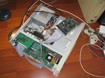

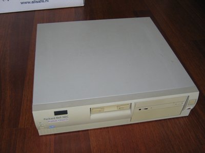

Today I received the following system:
76.36 KiB
1687 views
This is a LPX system made by NEC just after they took over Packard Bell (explains the chassis format), mainly for the Japanese market (but the power supply has a 115V/230V switch). However, underneath the Packard Bell-y case there is a Intel CU430HX OEM board (unfortunately slightly cut down in places).

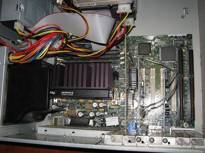

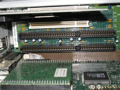

It uses a riser board with three ISA and two PCI slots (one shared with an ISA slot), has an on-board Bus Master IDE controller with two IDE connectors, on-board floppy interface, ATI Rage II VGA with 2 Mb of SGRAM (1 Mb standard + 1 Mb expansion board) and video feature connector, and Soundblaster Pro/Vibra 16 - unfortunately where the manuals states there should be two MIDI/waveblaster headers this OEM version lacks the headers, also the LAN port was left off.

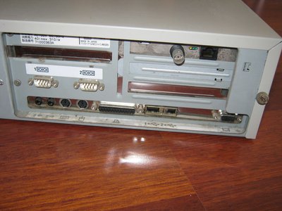

The rear shows that it has VGA, 2x USB, a parallel port, PS/2 connectors for mouse and keyboard, line-in and line-out connectors, but also two serial ports that are connected to the main board with ribbon cables:

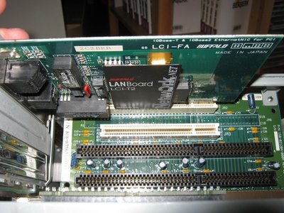

Also present is a PCI LAN card by Japanese IT company Buffalo:
208.69 KiB
1687 views

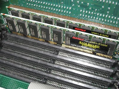

And the 32 Mb of RAM are made by the same company:
227 KiB
1687 views
One nice thing about this system is that it supports ECC modules, with a maximum of 192 Mb RAM.

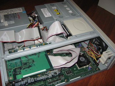

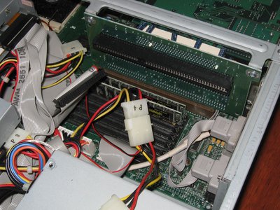

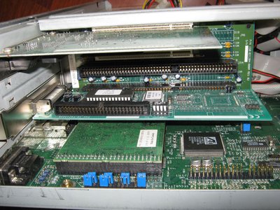

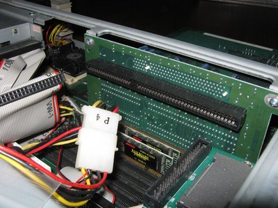

Reply 1 of 21, by yawetaG

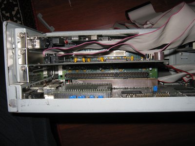

The riser board sits in between the memory slots/sound card portion of the motherboard and the video portion:
220.3 KiB
1685 views
235.03 KiB
1685 views

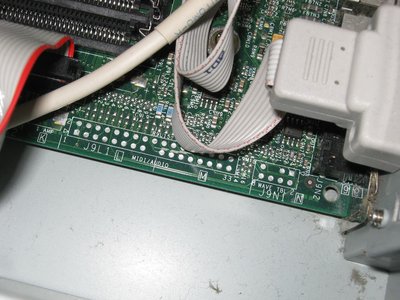

Missing wavetable headers on sound card portion of motherboard:
187.17 KiB
1685 views

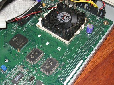

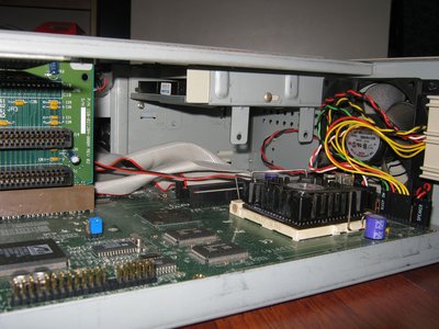

The processor only has a small heat sink and fan:
299.45 KiB
1685 views
...but there's a big fan that's attached to the front of the case and that sits right next to the processor. When I tested the system the processor fan was a bit noisy, so it might need replacement or a drop of oil.

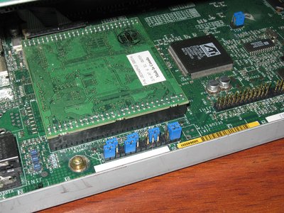

The missing item next to the processor is for a COAST socket - not sure what the performance impact of missing that will be...
The motherboard's jumper settings are indicated on a sticker on the inside of the case cover:
105.15 KiB
1685 views

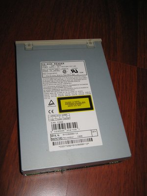

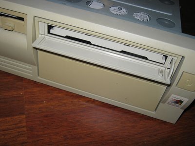

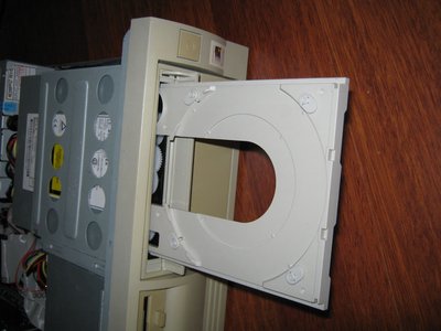

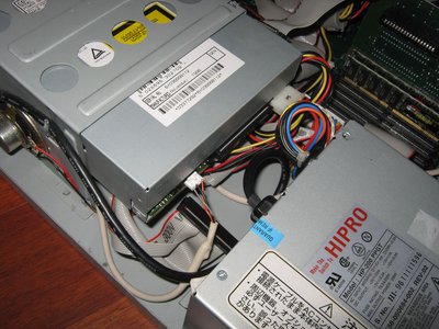

The CD drive on this machine is really cool, IMHO. It uses a tray that looks like a combination of a CD-tray and cart system, with a little door that opens up when the tray opens (and needs to be manually closed again once the tray is closed) and little moving tabs to keep the CD in place that move when the tray closes:
126.46 KiB
1681 views
114.37 KiB
1681 views
Surprisingly, the CD drive still seems to work flawlessly after 20 years... It also is a standard IDE drive. Unfortunately the system doesn't support booting from CD.

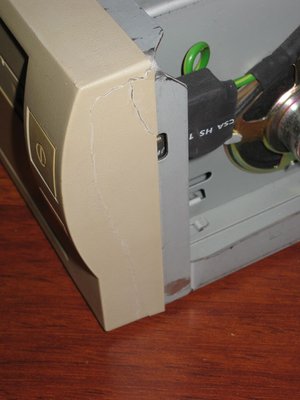

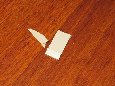

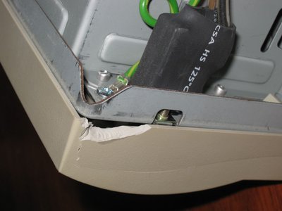

The case unfortunately suffered some minor damage during transit:
86.23 KiB
1681 views
256.01 KiB
1681 views
I'll try repairing the damage to the outside by gluing back the broken piece, but the other part is one of the clamps that holds the front bevel in place. 😒

Yesterday I repaired the case damage by gluing the bits back in place with superglue:
97.38 KiB
1637 views
Not a perfect fix, but will do.

I've identified the CD drive by the way, it's a NEC CDR-1400a, a 8-speed drive (just slow enough to not be noisy and just fast enough for decent loading times).
Besides the missing headers it also lacks a game port...

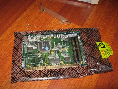

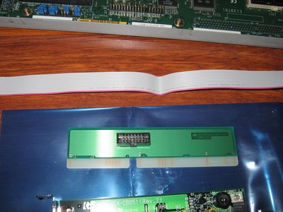

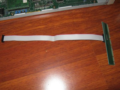

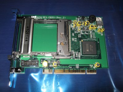

As I mentioned in the recent purchases thread, I got my hands on a PCMCIA adapter, which I wanted to use for this system:
129.67 KiB
1313 views
(Yeah, I know it says "Windows 98", but as you'll see, that would not matter for this system anyway... 😐 )
First, some better looks at the card than what I showed in the other thread. It's a PCI card with an ISA bridge board, suitable for both 16 and 32 bit PCMCIA cards:
189 KiB
1313 views
184.22 KiB
1313 views
The boards are connected together using a flat cable:
198.16 KiB
1313 views
(Since I was working on the system I also pulled out the network card and took its picture:
179.95 KiB
1313 views
But well, that's an aside...)

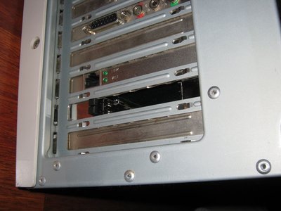

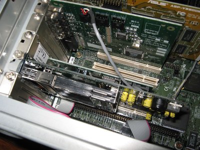

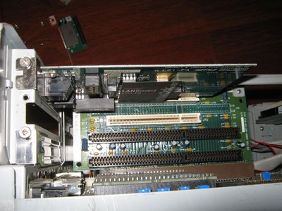

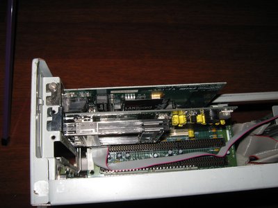

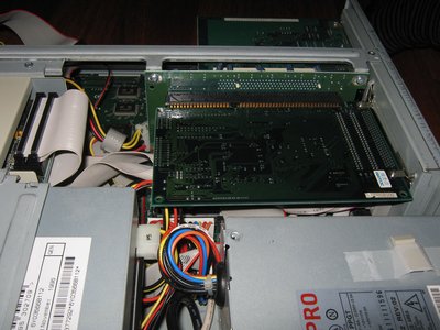

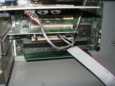

I installed the ISA bridge board and then tried to put the PCI card in the slot:
133.09 KiB
1310 views
It fit in there very tightly, in fact too tightly, because one of the eject buttons hit the case, even if I removed the plastic part of that button:
110.28 KiB
1310 views
The slot for installing the PCMCIA cards also sits too low, and I couldn't screw the card into place.
It seems the spacing for PCI cards in this PC case is just a little bit off, so the slots are located too far back a fraction of a milimeter, but also a mm or so too low. So no go. 😵

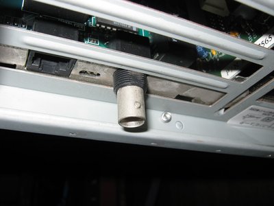

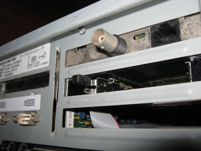

I then noticed this:
98.41 KiB
1310 views
To get the network card to fit, they had to file off part of the BNC connector! 😲 😲
So it looks like I will only be able to use ISA cards in this system...

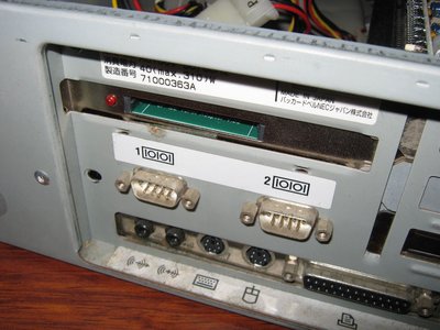

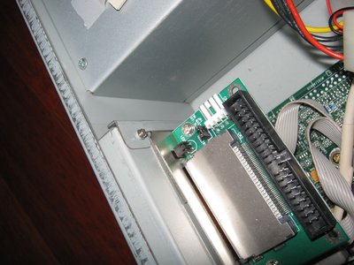

I did however add a slot-mounted CF card adapter to the case:
140.82 KiB
1310 views

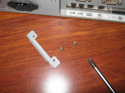

Now on earlier pictures, you might have noticed the power supply actually obstructs the screw hole for this slot. The solution is simple:
218.13 KiB
1310 views
There's this little bracket that holds the slot bracket in place (and actually no screw hole in the usual place).

The CF card adapter almost entirely clears the ISA slot on this side:
194.6 KiB
1310 views
I wonder whether there are internal cards that would fit in that space...
I will need to get an adapter cable to be able to hook up the power, as the CF card adapter takes a floppy drive power connector and the power supply only has one of those. I'll also have to sort out the cabling as it's a big mess right now.

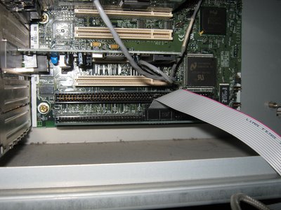

In goes the ISA bridge board with flat cable attached, in the lower ISA slot:
187.21 KiB
1310 views
182.07 KiB
1310 views
Reply 12 of 21, by yawetaG
And the PCI board goes in the PCI part of the shared PCI/ISA slot right above it:
230.94 KiB
1310 views
It still is a tight fit. But this time everything sits at the right height:
118.23 KiB
1310 views

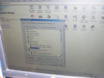

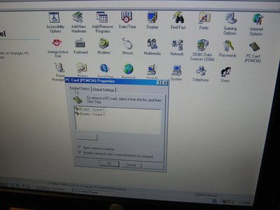

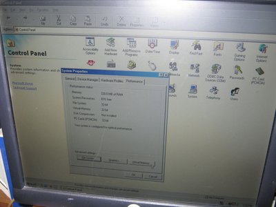

After closing the case, connecting all cables anew, and booting up, Windows 98SE finds the card, asks for the Windows 98SE CD, finds the drivers on there, one reboot later, and then the card is fully functional and shows up in device manager:
99.68 KiB
1310 views
I gain a PC Card thingie line in one of the other tabs too:
112.51 KiB
1310 views
And there is a specific PCMCIA control panel available:
107.03 KiB
1310 views
Each PCMCIA slot is automatically assigned some resources, and the only slightly worrisome thing I've seen is that one IRQ is shared with the soundcard (guess I'll disable the parallel post in the BIOS to free an additional IRQ). Can't show much more, as I currently lack PCMCIA cards that would serve some purpose in this particular system.

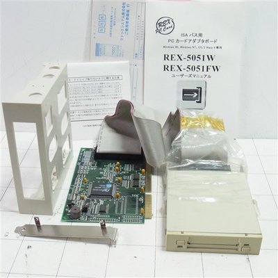

62.87 KiB
1066 views

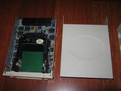

Blank slot cover, and the PCMCIA card "drive" will go into the 5.25" bay that's still free. Should fit, right?
Reply 14 of 21, by yawetaG
Having finally received the new PCMCIA card and bay, today was time to get it into my NEC.

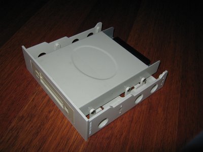

First, a look at the bay:
145.02 KiB
963 views

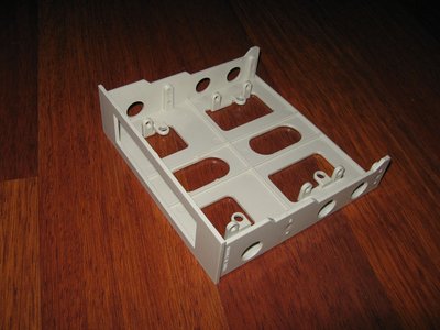

It can easily be opened because the (metal) top is attached using the same screws that are used to mount the bay into the PC.
Also included is a 5.25" to 3.5" adapter, all plastic, to which the PCMCIA bay mounts with 6 longer screws than the standard ones:
146.65 KiB
963 views
111.73 KiB
963 views

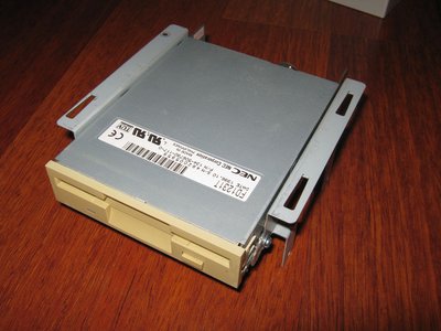

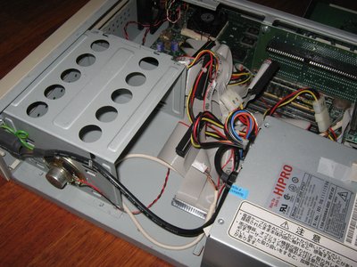

I'll have to use this, as the NEC only has one 3.5" disk drive bay.

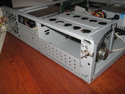

To be able to install the PCMCIA bay, I have to remove the floppy drive/hard disk cage to be able to remove the CD-ROM drive so I can have enough space to access everything (and also sort out the cabling). A better look at the floppy disk/hard disk cage:
151.95 KiB
963 views
143.15 KiB
963 views

CDR-1400A CD-ROM drive with readable label:
133.88 KiB
962 views

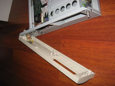

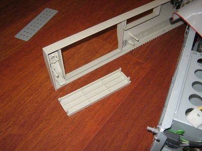

To be able to install the drive bay adapter I have to take the front off the case, remove a metal blocking plate on the bare case itself, and a plastic one on the case front:
148.67 KiB
962 views
165.07 KiB
962 views
165.03 KiB
962 views

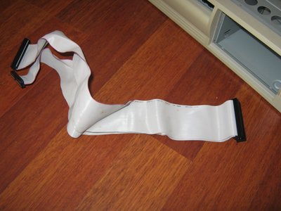

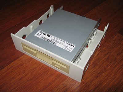

First do a crude test fit of the cable for the PCMCIA bay:
136.26 KiB
961 views
167.68 KiB
961 views
This showed the cable was just too short. So it was time for a different solution:
153.24 KiB
961 views
132.18 KiB
961 views
182.83 KiB
961 views

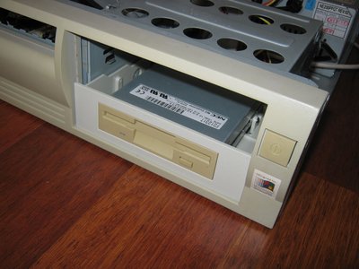

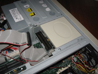

I swapped the PCMCIA bay and the floppy drive, and mounted the floppy drive in the bottom 5.25" bay. This also allows me to route the floppy cable much more efficiently, as well as use the same power cable for floppy and CD-ROM.

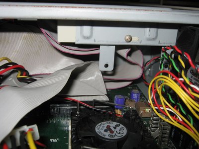

Reply 17 of 21, by yawetaG

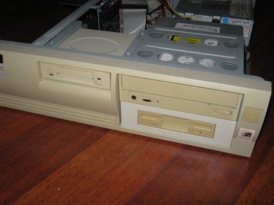

Then I put the CD-ROM drive back in place:
187.39 KiB
959 views
A test fit of the PCMCIA bay on the old location of the floppy drive shows it fits pretty much perfectly:
119.68 KiB
959 views

...and there's much more room and a less big mess of cables underneath.
I thought the shared ISA slot would be the perfect location for the ISA PCMCIA card:
178.88 KiB
959 views
Reply 18 of 21, by yawetaG
...to put in the ISA card:
297.91 KiB
958 views
Like so:
160.17 KiB
958 views
But the PCMCIA cables were very hard to route through the case and almost completely obstruct the air flow:
201.23 KiB
958 views
So I removed the slot-mounted CF-card reader, and put the PCMCIA ISA card there:
198.82 KiB
958 views
169.28 KiB
958 views
Reply 19 of 21, by yawetaG
This took several attempts because I had to route the cables carefully to get them to fit. Air flow still looks pretty bad:
152.53 KiB
957 views
...but it looks worse than it is, and there's quite a lot of free room behind the cables. As long as I leave the hard disk out it will work out I think.
Summary:
- 1 ISA slot less, one 5.25" bay less, no bays left free (except for the hard disk bay).
- 2 PCMCIA slots gained.
- Less cable clutter.
- Primary IDE cable and other power cable are now routed towards processor/graphics/free slot area, so I can hopefully find a solution to fix the CF card adapter somewhere in the vicinity.
- 2 ISA slots still free (one shared with a PCI slot with incorrect spacing to the back plate). There's also a VESA feature connector still available...
Maybe I should add a hardware MPEG decoder card? It needs to have drivers for Windows 3.x and/or Windows 95. Adding a separate graphics card is not really necessary, the on-board graphics are ATI Rage-based.
I could also add a second sound card to compensate for the on-board Soundblaster missing the game/MIDI port and wavetable headers...
