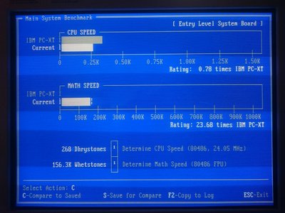

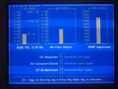

carlostex wrote:
I would like to see this machine benchmarked by checkit as it gives Dhrystone/Whetstone scores.
For the following configuration: Baseline 1 (slowest for board), Tseng ET6100:
3.63 MiB
1579 views
Checkit 2.1
3.77 MiB
1579 views
Checkit 3.0
Dhrystones: 268-276
Whetstones: 1563000-157000
Is this what you are looking for? I can post more benchmarks as well - let me know if you prefer Checkit 2.1 or 3.0 for these results. I could also try the ISA Tseng ET4000AX...
CPU is slower than an 8088 at 4.77 MHz for this configuration and the FPU is significantly faster than an 8087. I'm wondering if anything used an FPU that would be speed-sensitive in this speed range?

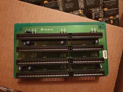

Regarding the build itself, I've been sidetracked but will get around to finishing it. I've shortlisted a few nice AT cases. My choice of PCI card lengths are limited due to motherboard layout, so I've picked up some PCI riser cards.
I'm thinking of ways to mount cards securely in an appropriate case. This can leave me to use 6 ISA cards alongside 2 PCI cards. Would using both the shared ISA/ PCI slots cause any issues? I'm not sure it would.

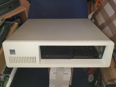

Trying to get some progress on the build, so I thought I'd try to dig up a case and picture the final result. I have a few AT beige boxes - two mid-sized tower cases, one with MHz LCD display and a Turbo button, and another without. Also a desktop case with a Turbo button but no MHz display. Since they are buried in boxes, found this case nearby:
1.8 MiB
1209 views
IBM XT case
Might be okay for this build - thoughts? It's a bit tatty at the moment.
It's easy to forget that Turbo switches weren't present in the earliest case designs.
Reply 31 of 45, by MrSmiley381
I'm a big fan of the original XT case. One issue is that half-height drives require an additional mounting kit, which can be a bit pricey on eBay. Not sure if someone made a newer kit for that or if your DIY skills can make that a non-issue. The XT PSU may be low-powered for your build and if so you'll need a replacement PSU that has a power switch in the same position, or something where you can rig a switch elsewhere. There's also the lack of a turbo switch and front-panel speed LED, but you knew that already. There's a little panel on the back of the XT that you can drill mounting holes for anything you might need, so that's an option. Alternatively, if you're planning to use half-height drives you might not need four bays for media. In that case, you can build your own front panel and go nuts adding features not otherwise included on the case.
I spend my days fighting with clunky software so I can afford to spend my evenings fighting with clunky hardware.
Reply 32 of 45, by j^aws
MrSmiley381 wrote:
Thanks for the insight - this is really helpful as I don't normally work with XT type cases. There are a number of pitfalls that are easy to miss. Another pitfall that just occurred is that the motherboard layout for the CPU would mean its position falls around the inner bays, which means I may have to sacrifice them. I try to get cases with 4 half-height bays to add numerous expansion options. Hmm, I like the idea of this iconic case that started the PC standards we have today. May have to reserve another board for it with a more accommodating CPU layout...

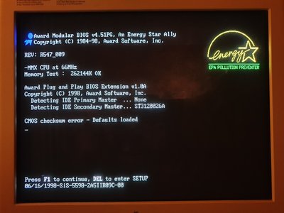

So I tried booting the R547 board after a long hibernation period and it gave me scares as it wouldn't POST. The fan kept spinning with no boot screen. Some random jiggling of inconsequential wires suddenly brought it to life. I must say the POST beep sound must be the most musical sound to builders ears! And I'm reminded how flaky old parts can be and how they can die a silent death. I wonder if cold booting syndrome is a real thing?
After this scare, I'm posting the boot screen and BIOS string for reference and posterity:
1.38 MiB
1177 views
R547 POST screen

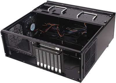

Reply 33 of 45, by j^aws
Choosing the case seems to be the hardest part. I have in mind a traditional beige AT case. However, the cards I want to use with motherboard layout is causing me to look at modern HTPC ATX cases. So far, the video cards I want to use:
PCI:
- Apocalypse 5D (PowerVR PCX2 and Tseng ET6100)
- Obsidian X24 (Voodoo 2 SLI)
ISA:
- Tseng ET4000AX
- Reelmagic Lite (MPEG1)
4 ISA soundcards
8 total cards, 7 slots on motherboard. If I use a PCI riser card, I'll release the shared ISA slot. The Obsidian would need to be on the riser due to being too long for the board layout. I'm thinking of a 7+1 ATX case like:
211.22 KiB
1153 views
7+1 slot case
You can see the 7 normal slots and 1 raised one above them. Anyone use these types of cases before? How would the top slot hold out to a long Voodoo card? It would lack the motherboard PCI slot to support it. What model cases have the above layout?

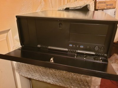

Reply 34 of 45, by j^aws

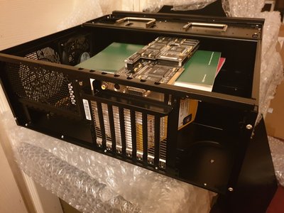

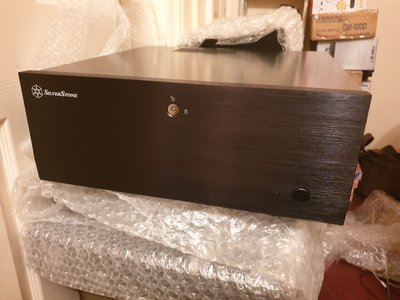

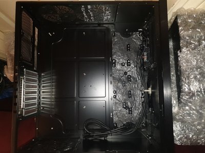

New arrival!
Bought a HTPC case for its slot layout to install the Quantum X24 and large number of external bays.
Nice and clean front, it's a Silverstone GD series with a brushed aluminium panel - looks nice IRL:
250.91 KiB
1123 views
Look at all those bays! Reminds me of old school desktops without front fans. The motherboard has on board USB, so could use those front access ports. Need to figure out how to swap out the momentary power on switch with a toggle one that comes with AT PSUs!
252.13 KiB
1123 views
Nice and spacious inside with ATX layout standoffs. Now, I wonder how many extra holes I'd need for a baby AT layout? The fewer I need to drill the better... I'm not a fan of working with metal! Might need to upgrade my drill as it's rather shite.
174.57 KiB
1123 views

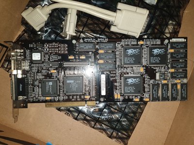

I need to get this Quantum X24 installed with the awkward motherboard layout and CPU placement:
665.57 KiB
1123 views
Fortunately, there may be a way to suspend it in the case...
307.27 KiB
1123 views
A test run to see how cosily it fits... I wonder if I'd need to give it extra support at the end to avoid it warping?

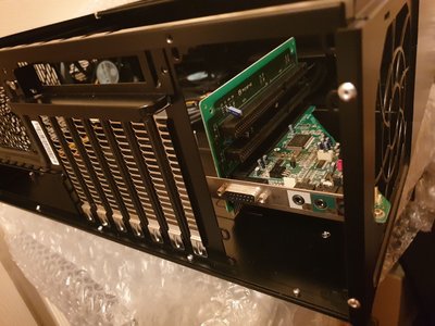

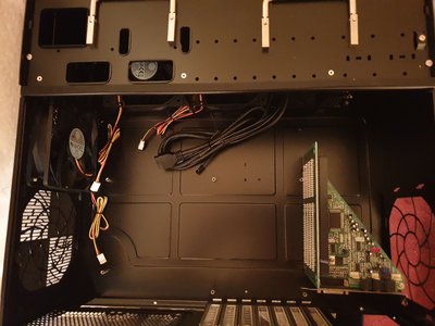

Reply 35 of 45, by j^aws

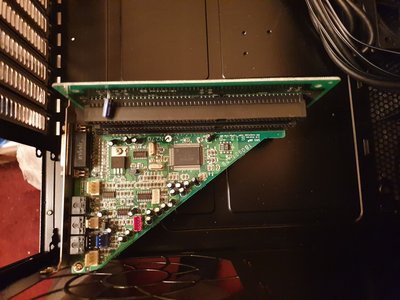

Further investigations in expanding the build with an ISA riser card:
357.86 KiB
1109 views
Secondary plans to possibly hack this into the case to extend the ISA configuration by a further 3 slots (9 ISA + 2 PCI).
333.39 KiB
1109 views
Eyeballing the install seems to be feasible.
290.49 KiB
1109 views
Birds eye view, which shows the PSU would need to be on the other side and mounted accordingly. A baby AT motherboard is fairly narrow, so maybe possible?
349.07 KiB
1109 views
How to secure the brackets for the riser cards? This view gives some further insight.
238.96 KiB
1109 views

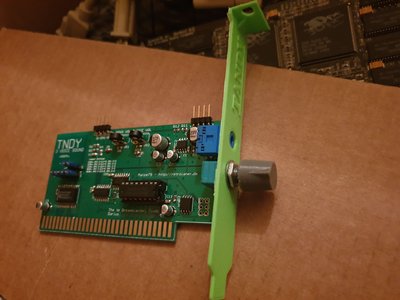

And this cutest of sound cards has arrived! Thanks Matze79!
This Tandy sound card will provide pre-OPL2 music for the oldest games to run on this build. If I can use the riser card, I'd stuff more 8 bit cards into this case... Hmm, which cards to include?

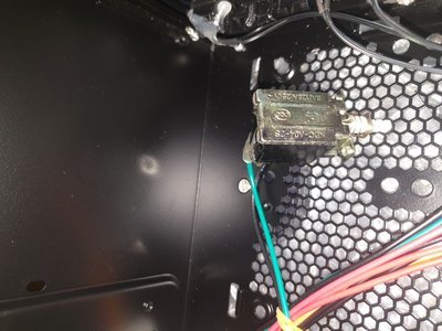

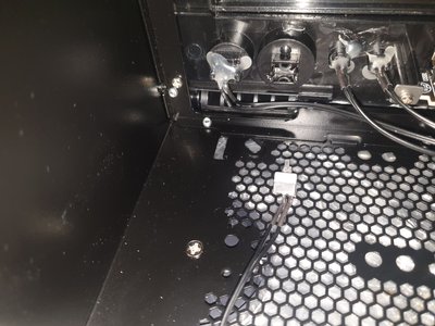

Reply 39 of 45, by j^aws

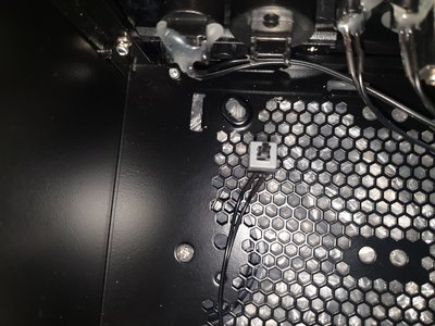

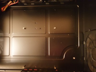

Did some more investigating to convert the case fully from ATX to AT. Firstly, I was looking to change the power switch from a momentary switch and install a toggle switch from an AT PSU.
456.78 KiB
1042 views
Silverstone case with fans and cage removed - very spacious.
391.79 KiB
1042 views

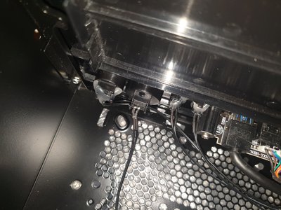

You can see the current switch just popping out of the large circular housing. Needed to remove the hot glue.
401.46 KiB
1042 views
452.2 KiB
1042 views
Couple of pictures with the switch removed.
369.55 KiB
1042 views
The AT switch doesn't seem like it will be easy to mount.
An easy win is seeing if the ATX switch could be replaced with another one housed identically, but toggles instead. Its housing is 8x8x8 mm, and the actuator is 5 mm long. Anyone know where I could get one offhand? And it also needs to be able to handle the current and voltage as well. I'll be using an ATX PSU conversion with the switch attached to its 20pin connector.
