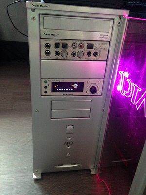

As some of you know already, my heart is with oldskool (1998-2008 era) high-end hardware. Have tons of it, gathered throughout the years. And now I finally got around to thinker with some of it.
So this is what I threw together last week;
* Cooler Master ACTS 220 case, the pink version. Bought this one new in box some months ago
* Antex 380 watt power supply (one that actually has all 3 of the required S423 P4 power connectors AND sata power connectors)
* An Asus P4T running 4 sticks of 128MB Samsung RDRAM
* An ATI Radeon 32MB DDR card, the OEM one so @ 166Mhz. I actually owned the exact same card 15 or so years ago so just had to have it again 😀
* A Soundblaster Live! with Live!drive. Still have to test the remote and all. Cool stuff.
* A Maxtor 60GB HD
* A dvd drive with the Cooler Master Alu bezel
* A NewQ audio signal processor
After a lot of hassle I was able to get Windows 2000 up and running more or less. Real pain in the ass to get these old machines properly hooked up to the i-net AND updated.
But admittedly that's part of the fun, right ? 😀
What I still need to do, is get the Soundblaster up and running. I downloaded the Live!Ware 3.0 CD from Vogonsdrivers but it said that the was no supported card detected so I guess I'll have to look into what exact model I have. If needed I'll just pick another one from my shelf.

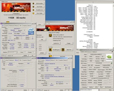

I'm messing with an Asus P4T motherboard right now.
Everything worked fine until I inserted the cable into the installed Intel NIC, this caused the computer to stall and eventually lock up. There is a known PCI bug with early i850 boards and using a Sound Blaster Live! like I also do does probably not improve the situation. I use 2x256MB + 2x128MB memory and a P4 1.5 @ 1875 MHz, the memory runs at 3x.
The solution for me was to install the lastest BIOS (1008.001) and disable all motherboard crap I do not use like the second IDE interface. Now everything works fine! I'm using a GF4 ti 4600 at the moment, I will let you know if a Geforce 6 series card (6600GT AGP with bridge chip) works or if I run into issues. I will also upgrade the CPU to a P4 1900 MHz and the memory to 1Gb when I get the modules I ordered.
Edit.
No issues with the Geforce 6600GT from what I can see, I did a quick 3dmark 2001 run with the P4 1.9 CPU, perhaps this issue only happens with 512MB sticks?
264.94 KiB
1328 views
