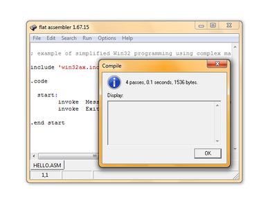

For Windows, DOS and *nix there's flat assembler. That's an open source macro assembler.
- And it produces damn small applications! The Hello world program takes up about 2KB.
https://flatassembler.net/
; example of simplified Win32 programming using complex macro features
include 'win32ax.inc'
.code
start:
invoke MessageBox,HWND_DESKTOP,"Hi! I'm the example program!","Win32 Assembly",MB_OK
invoke ExitProcess,0
.end start
    7.63 KiB
    534 views
    33.75 KiB
    534 views
