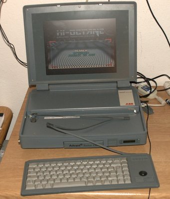

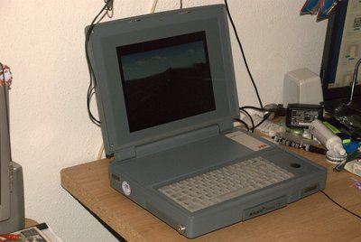

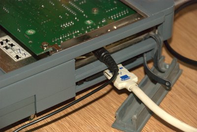

Something Special:
Advant Station with:
- Pentium 120Mhz
- 64Mb RAM
- 10Gb IBM 2,5" HDD
- Kontron Mainboard
- Floppy
- C&T 655534 Videocard PCI, 1Mb.
- Dust Covered I/O ports and floppy
- Hardened Screen (acrylic glass)
- Hardened Case (Massive Steel!!!)
- ISA Slot
- SCSI Onboard/External SCSI Connector (Adaptec)
- Creative Soundblaster AWE 32, with 2Mb SIMM
- OS: Windows 95C and Plus
PCMCIA Contains:
- 3Com Etherlink
- PCMCIA2CF and 4Gb CF Card
Used for maintance of power systems, generators and co as far as i know.
Different Machines are avaible in this Type of Chassis, its a assembly group.
388.04 KiB
556 views
Advant 130
460.54 KiB
556 views

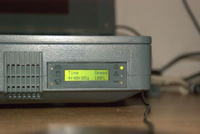

LCD - Runtime/Clock etc.
425.01 KiB
556 views

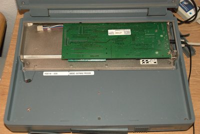

Soundblaster AWE32
442.33 KiB
556 views
PCMCIA
204.15 KiB
556 views
Keyboard off
It was equipped with a Big I/O Card with 68K CPU and Some RAM.
i will post a Picture when i have time to take one.
Replaced it with the SB AWE32.
Originaly equipped with Windows 2000 and 32Mb of RAM.
its a heavy Machine! and it can be carried like a suitcase 😀.
Also has internal battery for UPS purpose.
i removed it, because it began to leak.
More Pictures soon! 😀

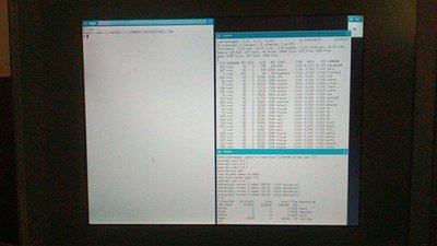

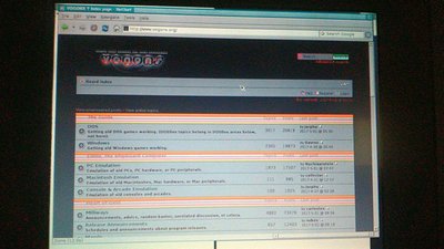

Reply 1 of 3, by matze79
Got NetBSD 7.1 up and running:
1024x768 8bit @ Xorg
Netsurf Browser:
171.98 KiB
474 views
150.62 KiB
474 views
now i can access modern shares and network services.
runs pretty decent, need to recompile kernel to get more RAM free.
Reply 3 of 3, by matze79
nothing, stock netbsd kernel runs here.
but Stock kernel is big, i need to remove all unwanted stuff when i will find time.
With GENERIC only 47Mb are avaible to User, it can be shrinked to ~4-5Mb and then i will have almost 59Mb free.
-> USB, ACPI, etc... all unnecessary.
EDIT:
installed with dosboot.com and netbsd_install.gz
No floppys used.
