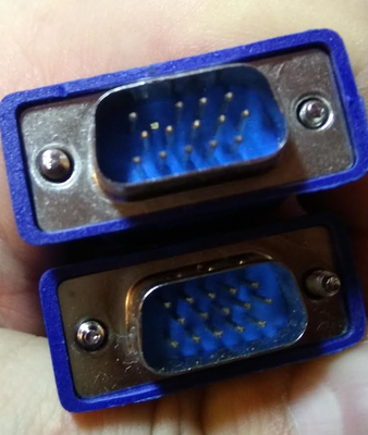

Before i will put my knife to the card i just want to make sure - i need to cut connection between pin 12 and pin 4?
Pic attached.

Reply 5 of 22, by opiate
Weird... so i've modded the cable, the pin 12 is out. Now there is no signal at all 😐 On old cable everything forks fine [fine means 'no color']
BTW: my LCD is not that new, it's Samsung SM 510N, 4:3 monitor
    571.55 KiB
    2267 views

And I should have been more clear how to mod the cable - My intention was to just cut open the outer plastic of the cable so that you can access all the wires inside the cable, and then cut a wire instead of connector pin. That way you could later on connect the wire again if it was the wrong wire. There's no need to remove pins as that's not reversible..
I think that cable is useless now. Oh and by the way, for future reference, the pins have small numbers next to them in the blue plastic to identify the pin number. Almost visible in the photo as well, but they are blurry.
