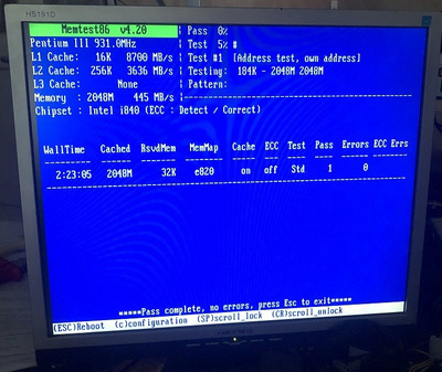

Yesterday I Memtest-ed my intel OR840 motherboard with 4x512MB rambus (PC-800) memory. I received "new" memory moduls from EBay.
The mobo is dual channel, so the max RAM speed must be about 3200 Megabytes/s
According to the math: 400Mhz (memory base freq) * 2 (both edge of the clock) * 16bit (rambus memory module bit-width) * 2 (interleves - dual channel) = 25600 Megabit/s = 3200MByte/s
I don't know how Memtest86 calculates the memory speed, but according to the picture it is far away from what I expected. It is 13% of the theoretical maximum.
I think the theoretical memory access speed is limited between the i840 chipset and the CPU.
The FSB is 133MHz, and the P3 CPU has 64 Data lines.
Math: 133MHz * 1 (only falling edge of the clock) * 64bit = 8512 Megabit/s = 1064 MB/s
(for a P4 1600MHz it looks like so: 100Mhz (base frequency) * 4 (quad data rate, 4 sampling during one clock cycle) * 64 bit = 25.600 Megabit/s = 3200MByte/s . So the RAMBUS PC-800 is constructed rather for this CPU)
That can be valid only, if the CPU communicates ONLY with the Memory. In the real world the CPU in between is polling the I/O channel as well, which uses the same 64bit databus of the CPU.
I had the question yesterday, why using Rambus with P3 if the 133 MHZ FSB has so slow memory access.
I think it is because the OR840 MOBO has 2 CPU capability, so both CPU can transfer from/to memory without speed drawback.
I have also a dual P3 MOBO with 4x512 Kingston SDRAM (133Mhz) where the max speed is around
Math: 133MHz * 1 (only falling edge of the clock) * 64bit (memory module) * 1 (interleaves - single channel)= 8512 Megabit/s = 1064MByte/s
Important to mention, that the CPU is not reading memory itself on demand. The CPU is filling it's cache with block of data from the i840 chip. The i840 has a very fast (3 times faster than the CPU) memory access, so I can imagine that after i840 gets the memory content very fast and buffers it, the i840 is feeding the P3 slowly 😁
I am curious if the i840 chip can feed the two P3 concurrently, I mean whether the data lines are shared between the 2 cpu, or separate.

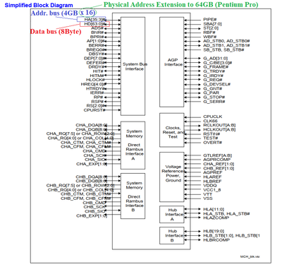

I investigated my last question by reading the manual of the i840 chipset from this PDF:
http://ww.ic72.com/pdf_file/8/81828.pdf
According to the picture below, there is only one shared address/data bus between the 2 processors.
That means, no matter how fast our RAMBUS ram is, every time when CPU1 and CPU2 wants to access to the memory in the same time the one or the other has to wait until the i840 feeds the one.
The 2 CPU does not have shared "L3" cache so if the CPU2 wants to access the same memory where CPU1 already wrote some data, CPU2 has to wait, until CPU1 is writing back the content of the cache into the RAM, by using the slow FSB speed (ca. 1GB/s) and waiting again until the i840 feeds the CPU2.
Here comes the interesting part: If Windows NT (or 2000, XP) is smart enough, it does not let CPU2 to work on the same thread with the same memory content, to avoid the cache write back thing, which steals a lot of execution time.
I was reading somewhere else, that the P6 architecture (P Pro, P2, P3) has the so called "out of order execution" which means, if the cpu wants to access a memory, which is not available in the cache, then during the waiting, the CPU executes the codes, after this memory request, and temporarly stores the values somewhere, and then stops, until the memory content is available in the cache. Then executes the instruction with the memory (which is available now), and then uses the prevoius stored result immediately. Unfortunately it is not much help, if the following instructions are working only with the memory, which is missing from cache.
More info about out-of-order https://slideplayer.com/slide/9408677/
I was also thinking, why the OR840 has so fast memory access (Rambus PC-800), which is 3 times faster than the FSB. The answer probably they wanted to make a 2 times faster access( because we have 2 CPU), with the PC-600 memory, but they probably decide to let PC-800 also working with the board.
The only way to have the advantage of that fast dual channel rambus memory, is to use a P4 processor with the quad data rate FSB, which datarate I calculated in my last post.
