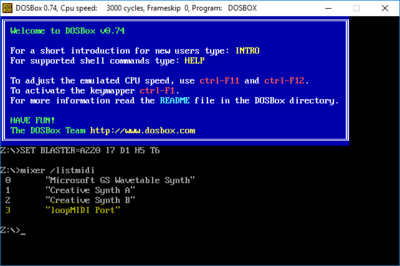

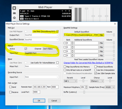

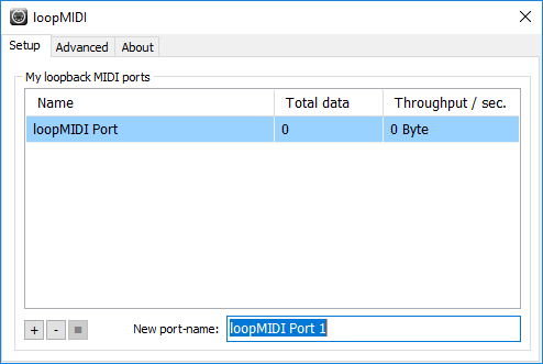

Hmm here is a checklist that you can try:
- Install loopMIDI, run it, and add (+ button) a virtual device, don't close it
- Run MIDI Player and configure the input (loopMIDI) and output (Use Bass and load a .SF2 SoundFont)
- Run DOSBox, and type mixer/listmidi (it should show loopMIDI) and note down the ID number
- Edit DOSBox config and make sure midiconfig=ID number from previous step. In my case midiconfig=3
- Run SETUP or INSTALL of your game and configure it for General MIDI
I think that should do it. Below are some images for reference.

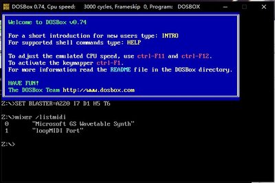

I've already did that but still failed, this is why it confused me a lot.... T_T
Please see my attachments

Yea that all looks good. And the game is configured to play General MIID? Maybe try another game, or setup program test, like in Descent.

Thank you so much dude, problem solved.
