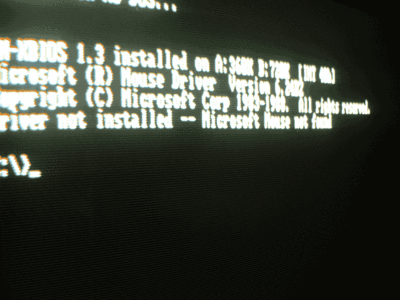

Edit: Just tried the 2M-XBIOS and it seems working here (device=2m-xbios.exe A:1 B:3, no /13 switch required):
I re-formatted a 3.5" 360KB disk using Format without problems. Machine is a Nixdorf 8810 M35 (specs).

Reply 11 of 19, by Deksor
Like I said, it's munch newer than the machine (came with a cheap 386 from the early 90's I think).
I managed to make it detect 1.44MB floppies ! I patched IBMBIO.COM. This allowed me to use DRIVPARM. Even though DRIVPARM was not outputing any error, it didn't seem to make me able to read bigger floppies ... However I re-tried 2m-xbios.exe and now it works 😮
Unfortunately, in order to be able to edit ibmbio.com, I had to create a boot floppy and use the attrib from one of my windows 98 machine to remove the "hidden" attribute, I don't know how to use DOS 3.3's attrib and I've read that it can't do that ... So I don't know how I can unhide the IBMBIO found inside my hdd to replace it with the patched one 🙁
Edit : okay so now for some reasons 2m-xbios works fine from the HDD without touching to the ibmbio.com file. I don't know why, but that's now a problem solved 😀

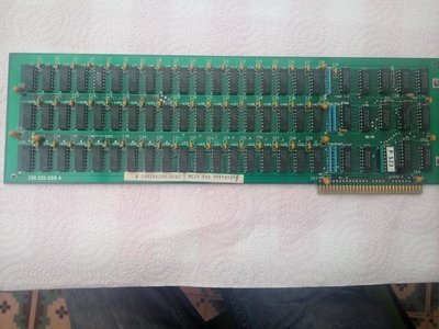

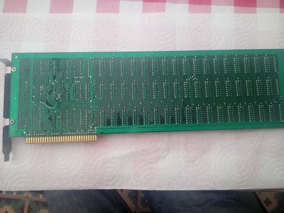

Now, at the beginning, I talked about a ram card of some sort that doesn't seem to work. Here it is !
1.05 MiB
701 views
1.03 MiB
701 views
Now the problem isn't a driver problem (... for now ?). Simply when I insert the card in the computer, the computer doesn't POST anymore. I checked if the caps were shorting and they don't so the problem might not be there ... Any ideas ?

Reply 13 of 19, by Deksor
I tried this card again, obviously the computer didn't output anything on the screen but at some point I tried to press the numlock key and the numlock led turned on ! I wasn't able to reproduce this but it looks like the card is in fact messing up the signals and not the voltages so there might be a dead chip or maybe there are caps that are dead (this is going to be a pain to replace and it will be costly 🙁 )

Reply 15 of 19, by Deksor
This board has two rom sockets. One is filled with the bios an the other is empty. I've got two other XT motherboard which are coming from two IBMs 5160 they have two rom chips so I guess I could just swap them if I want an IBM bios

Reply 16 of 19, by Imperious
The only bit of advice I can give with respect to the Ram card is check for dry solder joints and whilst turned on check and see if any of the chips get
unusually hot.
Hot Ram ic's are a common problem with older computers, especially c64's and others from that era.
Reply 17 of 19, by Deksor
I checked if there was any overheating chip and all I can say is that these 4 chip are getting a little warmer than the rest ... the rest being cold

Reply 18 of 19, by elianda
It is still unclear to me, what you want.
What do you expect the RAM card to do?
Where does the RAM actually decode to?
If your computer has already 640 kB, what is the point to add a 512 kB card? Shouldn't it be a EMS card then?
Youtube Channel
Reply 19 of 19, by Deksor
Actually I don't know what kind of ram card this is ...
For sure it has ram chips on it, but I don't know if it's an XMS card, and EMS card or whatever else ... I'm new to this stuff so I don't know as munch as you do ^^
