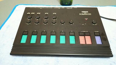

Latest update: Got a quite old and cheap 6 channels mixer, a YAMAHA-KM602 in a relatively good condition, within 6 dollars. I was so happy and very confident on this piece of hardware as it is branded as YAMAHA, but got a serious lesson after its delivery!
SHOULD NOT TRUST AN ANCIENT AUDIO HARDWARE!!! ESPECIALLY THE ANALOG ONE!!! (Unless tested as 100% of functionality by yourself before buying it)
I can't say this piece of shit is completely a disaster, but extremely troublesome and annoying, tons of problems such as not fully functional, bad connecting problems on the ports, knobs and slide bars, strong em interference caused by its over aged hardware and circles....
There are cheap things with nice prices for sure, but "NICE THING COSTS MONEY" is an eternal rule u should think a lot before risking yourself into a kind of extreme adventures...

Sorry to hear that.

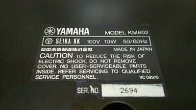

Did you google the model before buying? It seems to be from 1984...and close to no hits on popular pro audio gear websites that describe a good experience.
It may be worthwhile to open it up and clean out the contacts. Yamaha units that age are more or less notorious for badly responsive controls due to dust getting under the buttons (guess what withholds me from buying certain classic Yamaha drum machines?).

I am pretty sure that some electronics cleaning spray will do wonders with that yamaha mixer, you need to get the spray inside the sliding parts and connectors - meaning you'll have to open and disassemble the mixer - but the end result might worth the investment in time !

It's rather likely that's the case, yes. Most of this kind of gear was build to last, audio professionals often still have gear in use that's 30-50 years old.
Also be sure you set the gain switches properly for hooking up consumer gear to professional audio gear. That can sometimes make the difference between bad and proper sound.
