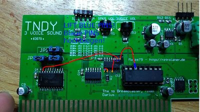

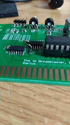

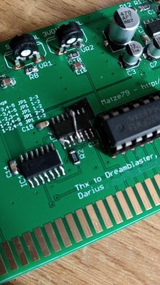

Reply 262 of 456, by matze79
Fix for graphical glitches with some cards..
    161.44 KiB
    1529 views
    131.26 KiB
    1529 views
    127.24 KiB
    1529 views
    101.1 KiB
    1529 views
    74.4 KiB
    1529 views

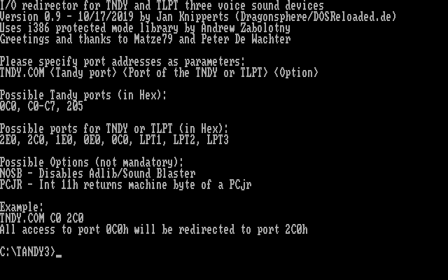

Reply 265 of 456, by matze79
More News, Testing Software and TSR development continues 😀
TSR:
5.83 KiB
1486 views

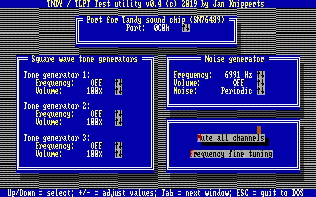

Fully featured Testing Programm for 3 Voice Chip:
6.25 KiB
1486 views
    Tandy(2).zip
    13.56 KiB
    79 downloads
    TSR 0.9 and Testprogramm
Reply 267 of 456, by matze79
Here on
https://github.com/JKnipperts/TNDY
Reply 268 of 456, by bjwil1991
I have a Lo-Tech Tandy 3-voice card in my 486 and when I run King's Quest 2 or the Sierra On-Line demo programs using the Tandy voice, I have graphical glitches. Other King's Quest games, including Space Quest 1-2, and Police Quest EGA are working fine.

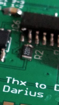

Reply 269 of 456, by matze79
You need to add 2k2 Resistor from READY to VCC on the SN76489.
The LoTech Card is missing the PullUp for SN76489.
Also add the 68pf as shown above to reduce noise a bit.
Maybe this will fix your issues ?

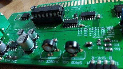

Thank you. I will buy some caps and resistors and fix the issues. My GPU is a Cirrus Logic CL-GD5428 VLB integrated on my Packard Bell Pack-Mate 28 Plus. Also, would it be a good idea to use a 47pF capacitor over the 68pF? There's a MicroCenter in my area that sells lots of resistors and capacitors, but no 68pF ones.
Reply 274 of 456, by Tiido
47µF will help but not as much as 68pF will. 100pF will work but probably begins to muffle sound. Two 47 is series and then parallel over 3rd 47pF should get something around 70pF which will be fine.

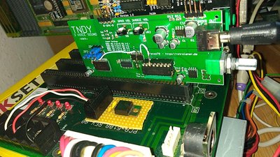

I added both the caps (3x 47pF caps to be ~70pF) and the 2K2 resistor and I still have graphical glitches in King's Quest 2.
Reply 279 of 456, by matze79
Do you also have Graphical Glitches with PC-Speaker ?
Do you run Card on XT or AT System ?
If you don`t have glitches with PC-Speaker and If you run on 386 + do you also get glitches if you run with TNDY.COM TSR with the Card located on other Adress ?
Add least you will no longer suffer from compatibility problems with sound blaster cards (Non-16) with the 2k2 resistor 😉
