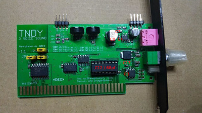

Reply 338 of 456, by matze79
Hi,
here are some corrections for Self Builders, in case you cant find the locations for the Parts.
234.18 KiB
1118 views
C12 is under the IC Socket for SN76489.
Some people did not respond to my messages so i still have Cards left, if someone is interested.
