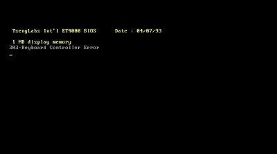

Having fixed that, the Compaq Deskpro 386 BIOS continues running past the Tseng ET4000 BIOS, now resulting in a "303-Keyboard Controller Error".
19.1 KiB
946 views
Compaq Deskpro throwing an error running the BIOS now.
Is the Compaq Deskpro 386 using a regular IBM AT-compatible 8042?

Reply 4 of 31, by superfury
I've added and modified the 8042 to be Compaq-compatible when using the Compaq Deskpro 386 architecture. The command overrides have been added, although the speed commands are largely a mystery, as nothing is explained in the Bochs ioports.lst file? Anyone can explain them?

I've managed to fix the keyboard checks: apparently no 0xFA(acnowledge) is given on the Compaq 8042(it's given on the AT, though) 0xAA self test command. It now passes the keyboard/8042 check and hangs/stops at POST Diagnostic code 09h(according to http://ryan.servehttp.com/tech/hardware/bios/compaqbios.htm, it's the Reset code in CMOS byte). So there's a CMOS or reset problem?

Anyone knows what's going wrong here?
When reading POST 53h, the cursor jumps down some, after which it seems to reset(it looks like a vertical tab is issued?)?
