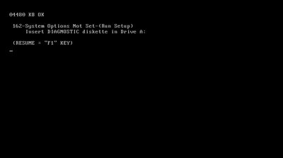

I've added a little functionality to the emulator to support XT/AT/COMPAQ text files in the ROM directory that contain translations of the POST code into a readable description.
POSTCODE.COMPAQ.txt
5.04 KiB
66 downloads
Compaq POST diagnostic code translations.
This results in the following log(formatted 2 hex digits, followed by a space, followed by the description to log, followed by carriage return-linebreak(Windows CR/LF line break combination)):
debugger.log
6.43 KiB
43 downloads
Log containing the currently generated POST codes based on the POSTCODE.COMPAQ.TXT in the ROM directory.
That would make looking up the tables a little less difficult(since you can actually see what it's doing). I've copied the first table from http://ryan.servehttp.com/tech/hardware/bios/compaqbios.htm to create the file. It also lists "Compaq 386 Deskpro BIOS Post Codes", but those can't be correct? I/O ROM error and System memory board failure immediately after powering on the CPU and initializing the basics(and continuing on)? So that block is probably incorrect?
Anyone can see what's going wrong?

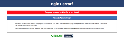

That page does not work for me. All I get is a nginx error.
Reply 23 of 31, by superfury
vladstamate wrote:
Strange: I get:

Here is what I get:
Reply 26 of 31, by superfury
Strange: it's arriving in my browser(Google Chrome). I've found an error sending the data from the 0x20(Read RAM byte 0) command: the port60tofirstPS2port(sending it back as a reply) is still set(supposed to be cleared). I've modified the code to clear it when using it correctly now. Now testing...
Edit: It's continuing to POST again! 😁

I've found a little problem in the 8042 emulation command switch cases missing 0xD1 command break(which continued into the 0xD2 command case, due to the missing break call). That fixed the 8042 itself. Then I still needed to fix the PS/2 keyboard reset command, which was clearing all data, losing track of it's second timeout(first a timeout on the 0xFA result, then a timeout on the 0xAA result. Since the 0xFA result was clearing all status(although setting some of the data again), it lost the currently executing command byte(0xFF), thus the second byte resulting in 0xFE being added into the buffer instead of 0xFA. This caused the BIOS to think the hardware wasn't correct and print a keyboard error.
Having fixed these two bugs, the Compaq Deskpro 386 BIOS now boots without any errors with 4MB installed RAM(+reserved RAM)(except uninitialized CMOS, which needs the Compaq floppy disk software to fix):
18.29 KiB
855 views
Compaq Deskpro 386 starting with no errors(except BIOS settings not setup yet).

So it's booting correctly now:D Still need to check on the IBM AT emulation, though(it will probably work better now too).
