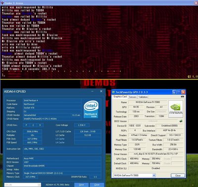

Reply 183 of 203, by SPBHM
279.81 KiB
2748 views
P4 2.4@3.0GHz, Asus P4PE, 1GB DDR333 SC, EVGA FX5900SE, Onboard sound, WinXP SP3: 280.7 fps
OP settings

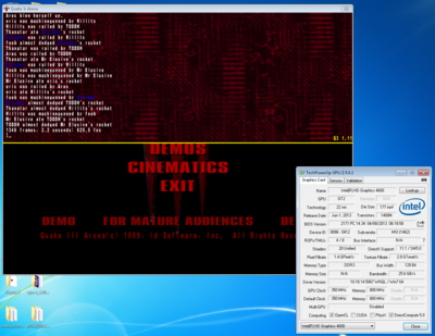

Reply 191 of 203, by Standard Def Steve
Some Haswell IGP fun.
Core i5-4670 running at Turbo Boost frequency (3.8GHz), 16GB DDR3-1600 CL9-9-9-24, Intel HD-4600 graphics, Win7 x64
All settings maxed @ 1024x768 = 625.5 FPS
874.79 KiB
2606 views
It's just amazing how much IGP performance has improved over the years. And Haswell's IGP is nowhere near as fast as the Ryzen APUs. I wouldn't be surprised if those could hit the 1000FPS limit.

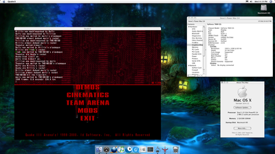

Reply 193 of 203, by Standard Def Steve
Here's your first PowerPC result!
PowerMac G4 MDD, dual G4 1.25GHz (166MHz FSB, 256K on-die L2 cache, 2MB external L3 cache per CPU), 2GB PC2700 DDR, GeForce 7800GS AGP, OS X 10.4.11
1024x768, all maxed.
1.78 MiB
2478 views
Well, the G4 sure sucked at Doom3, but Quake 3 is a completely different story! 227 fps from a mere 1.25GHz is nothing short of amazing. I'm starting to think that Doom 3 was just a crappy/lazy port.

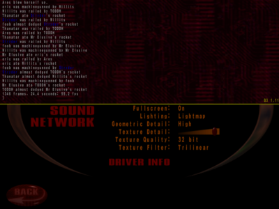

Reply 194 of 203, by Standard Def Steve
Today I slotted a "new" 512MB Quadro FX 4500 in my Quad G5 and did some benchmarking with Quake 3, Quake 4, Doom 3, UT2004, and Prey. This card replaced a 256MB X1900XT and so far I'm really pleased with it. It's a heck of a lot quieter, that's for sure!
Quake 3 absolutely flies on a G5. Memory latency on these machines is just dreadful, but man does that 1.25GHz FSB give it a ton of raw bandwidth. Say, doesn't that remind you of some other CPU/memory combination? 😜
PowerMac G5 Quad: 2x dual-core PowerPC 970MPs at 2.5GHz, 16 GB DDR2-533, Quadro FX 4500 PCIe, OS X 10.5.8
1.27 MiB
2072 views
