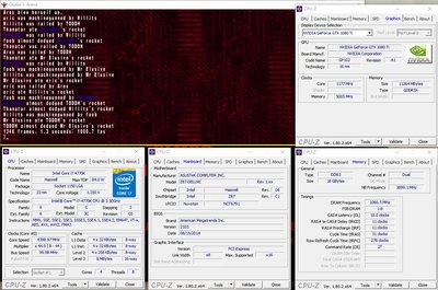

Reply 97 of 203, by Shagittarius
358.37 KiB
2662 views
I got this every run...this might be the limit.
