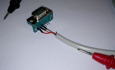

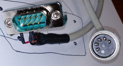

I made this cable from what I had available to me. The 9-pin male I desoldered from the backplane of a PCI serial card. The 5-pin DIN is from an AT keyboard extension cable. I have the 9-pin end plugged into the back of the MIDIMAN, and the DIN end into the MIDI-In of the MT-32. Unfortunately, either it's not working or I'm doing something wrong in testing. I don't currently have the audio out cables so I'm relying on the MT-32 LCD, watching for it to display text when I load games. It doesn't seem to be working. But in addition to a soldering or wiring mistake, it could be the MIDIMAN card, it could be port config and probably other things I'm not thinking of.
I cut the female end of the keyboard cable off, used a multimeter to trace the cables that belong to pins 1 and 6 (referencing Solarstorm's pinout photo in the other thread), then soldered those to the appropriate pins on the 9-pin end. I soldered the ground wire to one of the leads that originally soldered to the PCI serial card (the far left connection on the top photo). I realize these photos don't reveal much, but it's what I got at the moment.

I don't do a lot of soldering, so I'm sure I could have messed up in multiple places. If you spot something in these photos, can you point it out to me?
Thanks!

Reply 13 of 22, by keropi
can you check with a multimeter and show us which pin connects where? Have you tried soldering the cables on the DB9 the other way around? (pins 1 and 6 , swap them)

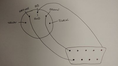

Well, the cable seems to be okay. I did continuity tests with the multimeter and everything seems fine, even GND beeps where it's supposed to and not on any pins. Here is a sketch of the pinout I made as I was tracing the wires:
759 KiB
2005 views
So Orange tones with pin 6 and Brown tones with pin 1. Red tones with any of the outside metal.
and the inside of each end of the cable:
180.22 KiB
2005 views
No, I have not swapped around pins 1 and 6. I suppose I could. I do notice now that the photos in that pinout thread are of a female DIN, so maybe my male end needs to be reversed?
Reply 15 of 22, by keropi

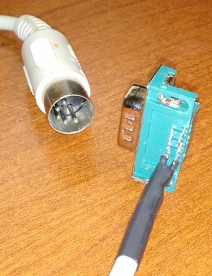

Reply 16 of 22, by clueless1
Because of the way the pins come out of the DB9 port, it's easy to visually trace them. I just swapped orange and brown on pins 1 and 6 and tested for continuity. Next step is to retest on the MT-32. I'll keep you posted 😀 And thank you for your guidance!

Reply 18 of 22, by clueless1
keropi wrote:
nice, now let's see if it works 😁
It does! Just tested it. 😎

Allright! so it was a mirroring issue 😀
