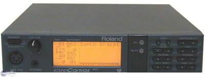

I found out 2 Roland SC-55s here, and neither of them is labeled with any "General MIDI" logo at all on their front panels, which means they belong to the first lot of SC-55 product lines without GM compatibilities.
So here is the questions:
1. Is it worthy of taking one of them into my new collections? I'm quite confused since I've already got SC-D70, SC-88, SC-55ST, CM-300, and CM-500 of Roland series, and MU-100, MU-500 of Yamaha series.... I think I should focus on other devices such as MT-32/MT-100, CM-32/CM-64, SC-8850/Edirol SD-90 and MU-2000EX, but still quite curious on these special SC-55s...
2. Even both of them has no GM logos, their GS logos are not quite the same. One is written as "GS Standard", another is "GS" only (see attached pics I googled for reference). So is there any difference between those two SC-55s? Which one is better (or a must-have) as a retro collection?
Thanks a lot if some advice could be given by you experienced guys here.
PS: 1. SC-55 with "GS" only logo
39.61 KiB
3111 views
2. SC-55 with "GS Standard" logo

James-F wrote:
Thank u, dude!!
So, generally speaking, there are no real difference between those two "GS only" SC-55s, and they are a kind of "must-have" for retro games if I want to have some of games' bgms played 100% accurately, right?

The earliest Roland SC-55s simply have a "GS STANDARD" logo on the bottom of the front panel, while slightly later SC-55s have a "GS" logo.  Modules with the GS logo may still be
"may still be" what??? Seems the last part of that sentence is gone......

Reply 4 of 28, by James-F
Generally, Yes. DOS Games => SC-55.
I would go for SC-55 MKII because it has bug fixes and better DACs if you can find one in your region, should be plenty in Japan.
"may still be General MIDI compatible."

I believe there are workarounds/fixes for most but maybe not all of the select early 90s games that do not play properly on an MKII. If you want an SC-55 model that 'just works' with everything you'll want a GS (no General Midi, no GS Standard) model that has a 1.20 or 1.21 firmware. These have BD, CD or DD serial #s. When I bought mine on e-bay I asked the seller to check the firmware version for me beforehand ...
SC-55/55MKII : Press the POWER button to make the STANDBY light come on. While holding both
INSTRUMENT buttons, press both MIDI CH buttons

infiniteclouds wrote on 2017-06-27, 00:06:
My 1.20 unit has serial AC94400. However, it does have a 'GS' face plate. From (lots of) reading I've concluded that 'GS' models can have too old, too new, and 'just right' firmware. However, it seems the serial doesn't say much.
Reply 18 of 28, by derSammler
For the Mk.II, the ROM version doesn't matter. It's only important for the Mk.I, because only 1.20/1.21 still has capital-tone fallback (later ones don't) and is GM compliant (earlier versions aren't).
Reply 19 of 28, by Cloudschatze
derSammler wrote on 2020-02-21, 16:36:
For the Mk.II, the ROM version doesn't matter. It's only important for the Mk.I, because only 1.20/1.21 still has capital-tone fallback (later ones don't)...
This is incorrect. All "SC-55" units proper, regardless of whether the ROM version is 1.xx or 2.xx, support capital-tone fallback.
