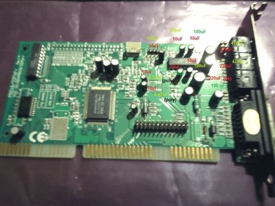

In my online search I noticed that my ALS100+ didn't follow the reference design for its capacitors.
Especially the OpAMP had caps installed which were off by factor 10.
I guess card makers just smacked-on the cheapest caps they could get and which matched in size and voltage.
red= actually installed (bad)
green= reference or good

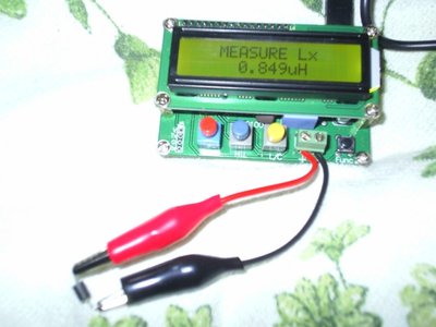

My first 100+ card also lacked a ferrite choke. I measured one of them, and it had an inductivity of 0.850uH (micro henry).
So I cut a trace on my first card to match the second one and installed the chocke.

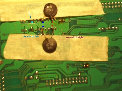

-Quick "fix"-
After some trial and error I found a way to lower the noise a bit.
To do so, someone has to add two caps at the inputs of the TEA2025, ranging between 10nF-100nF.
This de-noises the audio signal about enough to be on a bearable level.
Note that this is no cure, but relieves the distress and is more of an interim solution.
It also lowers the volume, so we have to compensate in the mixer.
This no problem, though, as the TEA has an internal thermal-protection and can hardly be damaged because of this.
As I said, it is more of an interim solution.. I'd be way more elegant to remove the noise at the source (bus, PSU, etc.)
It is, however, better than throwing the card into the bin or using a flamethrower on it. 😉

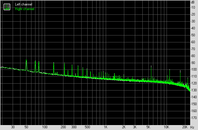

After some consideration, I also decided to design a 4-layer pcb pc/104 soundcard based on this chip to compare the noise and other things (see pics below)

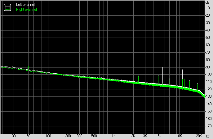

To record the noise for spectrum analysis I used a battery powered hi-fi headphone amp connected to a soundcard line-out and a battery powered WAV sound recorder with a line-in input.
Only the minimum amount of components were soldered during tests. mic\line-in\gameport\cdrom\amp components were removed and the soundcard itself was powered directly via 5V battery, no PC connection.
Here are the brief results I got:
1) PSRR voltage regulation will have little effect. I hooked the (removed from PC) card directly to a 5v battery. The noise is still there even without initialization or any connection to PC. Card initialization in DOS and mixer will only add a small portion of noise to it.
2) This noise is a "1/f" noise in nature (pink noise or flicker noise) and is insanely similar to "by the book pink noise generator" (see the spectrum of the noise below), which makes me think it's a design flaw rather than silicon\grounding etc
3) Ground loop isolation transformer will have no effect (unsurprisingly), but the impedance mismatch causes the noise to be reduced. Sound volume also suffers greatly, but if amplified again by the speakers, you can get somewhat decent volume and quality (by ear). I suppose this also can be done with resistors, but not worth doing anyway.
4) My 4 layer design PCB did not perform any better noise-wise (I'll do some spectrum comparisons later). But all PC "thinking" noises are gone. I used (analogSIG\power<>ground<>digitalSIG\power<>digitalSIG) PCB layers layout. The traces layout is completely different. Only DAC filter values are the same. The idle noise is absolutely similar to #1

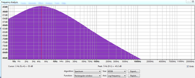

5) VREF1 and VREF2 IC outputs measure about 20mV peak noise (I'm sorry, but I could not make any pics, you'll have to take my word for it there). I cannot tell the spectrum either, all of my oscilloscopes are useless when it comes to audible band FFT
6) Disconnecting ALS120 VREF outputs and hooking the filter circuits directly to a LM4040 2V voltage reference did not improve things very much either (by ear). Interestingly, disconnecting VREF1\2 completely has no drastic effect either 0_o.
7) Bipolar electrolytic 10uF vs 10uF Y5R MLCC as coupling line-out caps perform absolutely identical
8) Shunting floating inputs via 10K to ground - no effect
I may add some additional tests later (e.g. -0.3v digital to analog voltage rail diff, ground pin lifting, etc ), but I'm not sure there's any point.
UPD: additional tests will be added there:
8) 5V analog side ON \ 5V digital OFF = NOISE ; 5v analog side OFF \ 5v digital ON = silent (which is logical, since I disabled the mixer section completely)
9) Lower digital voltage below analog voltage level and vise versa = no effect. Lowering analog voltage decreases useful signal levels.
10) Lifting GND pins, so only one pin of each plane is connected and far apart= no effect + pc thinking noises return
11) Dry ice freezing (just for giggles and in the name of science). No effect, but I think I overhead some silicon cursing and threatening to be back.
My conclusions (please, take #2 with a grain af salt, It's only my theory):
As much as it pains me (the soundcards itself are not that bad at all.Good compatibility and OPL), I'm afraid there's not much that can be done in terms of supressing the noise.
1) Bad PCB grounding, EMI or amplifiers are not the culprit. I could not find anything out of the ordinary there. Amplifier capacitors, which are out of spec are simply either buffer ones or gain. But of course, they contribute their small part too.
2) Based on a sketchy datasheet info and my experience, I'm considering the culprit to be the internal IC's reference voltage source. It is the only thing I found drastically different between ALS100 and noisy ALS100+\ALS120 (apart from integrated OPL on ALS120, but ALS100+ also has similar noise with external OPL chip). At some point, when probing VREF outputs, I somehow managed to internally shunt it. It muted the sound effects completely, leaving the music playing with much less noise. Here's the brief spec:
ALS100 - 100uA 2.25v VREF (very much like some opamp based reference)
ALS100+\ALS120 - 1.5mA 2v VREF (1.5mA makes me think of some cheap-clASS zener reference)
Zeners are prone to noise and ARE actually used as a source for 1/f noise generator circuits.
Next thing I assume, that for a cheap IC, resistor ladder was probably used as a simple DAC. vref noise there may get attenuated to form a 3db point.
In noise generators, resistor ladder is used to filter and attenuate the curve of the noise spectrum.
Of course, you cannot exclude bad op-amps/DAC, but I have not yet found such absurdly noisy ones (on the other hand, maybe I have just found one).
UPD: Poor dynamic range and output gain contributes to the noise problem.
Any additional input, criticism, ideas are highly appreciated!

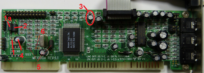

P.S.
Some noise reduction points, not much, but nevertheless:
You can only reduce it to some reference level. Below is the picture of the similar soundcard, where I pointed out the most affecting modifications:
1) A place to solder 7805 regulator, TO-92 package.
1a) Ferrite choke, which connects motherboard's +5v to the soundcard analog power rail. Should be removed when soldering 7805 to avoid shorting their voltages.
2) Ferrite choke, which connects analog and digital grounds to a single connecting point.
3) vREF bypass\buffer capacitors
4) This capacitor will significantly reduce whistling\thinking noises. Many cards miss it. (Monkey Island 2 for instance, make astounding high-pitch whistling without this cap)
5) Digital +5v ferrite choke and bypass caps
6) When crystal is not used\soldered, 100 ohm resistor is soldered there instead to carry signal from motherboard. The crystal itself uses 1.8M resistor in parallel in addition to caps.

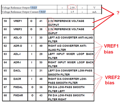

One more interesting thing, new chip fails to be detected by Avance Logic Drivers 0_o.
Unisound works flawlessly. Maybe there's some ROM info missing. IDK
Tiido wrote on 2022-10-05, 06:53:
Very nice effort ! Thänk you ~
One thing that may help is forcing your own VREF from a clean source into the VREF pin(s) and particular voltage can make a significant difference too.
Thanks for the suggestion!
I've also thought of that, but at the time I was worried that reverse voltage would damage the circuitry. And if it's a shunt based ref - it would just be regulated back with no effect.
Now that I have some IC's to spare and a prototype pcb, I may try it. I have jumper pins there, so it should be easy to test.
UPD:
Here's the result. recorded WAV file, software amplified
First 10 sec - idle card with both vref intact.
10-20sec - just attached the wire to vref 1 pin (some wire jiggling noise) to the output of the powered off power supply. Noise reduced already. If I put the wire out of the powered-off power supply - the noise get louder again.
20-30sec - forcing 0.8 volt on the pin, futher noise reduction
30sec and further - switching between 1.5v and 1.6 volts. Above 1.6v the noise becomes louder.
At exactly 2.4v on VREF1 pin the great portion of the noise is reduced. IDK how healthy it is, though.
The datasheet is sketchy - it points out 2.0V in one place and 2.5v in the other
Forcing voltage to vref2 has little effect. Forcing the voltage to both vref1 and vref2 adds buzzing, maybe ground loop
All I have to do now is to replace LM4040 2V on my prototype PCB with another ref chip and hope I will not fry something

Anyway, I've recorded two 1-minute long samples of idle noise. Default mixer settings
My prototype pc/104 PCB and a reference card with most of the components in place, excluding 7805 regulator.
The reference card appears to be more silent than mine, but also has some harmonics, which the regulator should suppress a little.
Extra point goes for split A/D grounds vs my lousy solid plane prototyping 😀

Now, it's "once more unto the breach", before I consider my options depleted : evaluate filter circuits (Nyquist freq, etc)
But I have some trouble figuring them out. (pls, see the pics below)
Any help or suggestions are highly appreciated.
I tried to draw the schematic more legible, than it is on actual pcb.
Without the IC's internal schematic it's a bit tricky for me to figure out what exactly the circuit does.
I've also drawn an assumption, how the anti-alias filter may be connected, although I don't quite get the purpose of 1nF caps, just a bypass?
Also, the type of the low-pass filters is a bit cryptic to me also.
Some of the resistors values seem a bit extreme to me.
