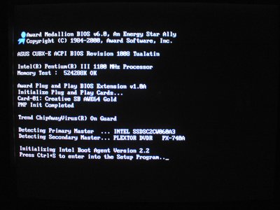

One short update... I couldn't resist the temptation to purchase a new Intel 60GB SSD for a very good price... So, I tested the configuration with another SATA SSD using a converter (SATA 300 to IDE), and the CUBX-E correctly identified the test SSD and tried to boot. Then I put in the Intel SSD, after partitioning, formatting and preloading it under Windows 7, booted via floppy and installed Win98SE directly from the SSD. I spent an hour setting everything up again and now everything's running like nothing ever happened 😉
    2.13 MiB
    2582 views
    POST
This Intel SSD can't be compared to other SSDs I've seen, especially not newer ones with cheap plastic cases... This one has a solid aluminum case and overall a very high quality look & feel. And it is fast, really fast, especially compared to the Transcend IDE SSD. Great piece of hardware!
I have updated the hardware configuration posts of Retro 1 respectively.

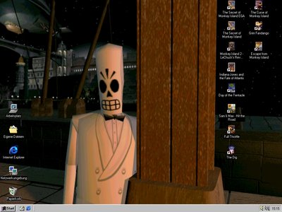

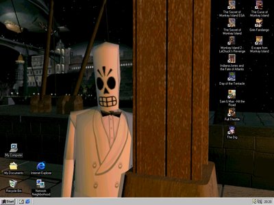

Now, all games are installed.
    481.83 KiB
    2561 views
    Retro 1 Desktop (Windows 98SE)
For DOSBox, I'll have to test the configurations to check whether everything's still working OK. The games do work flawlessly, I have played them countless times on a separate machine in DOSBox. That machine, however, is FAR more powerful than this one here. So, I'm basically verifying that the configurations yield the same result on Retro 1. For most games, I've already done that and adapted accordingly (e.g. the cycle setting for Full Throttle and The Dig, deactivating emulations not needed for the specific game etc.pp.).
The three Windows based adventure games are installed too and running without their CDs. I had minor issues with The Curse Of Monkey Island and Grim Fandango, both complaining about missing files or similar things. After double-checking everything I identified that the desktop shortcuts were missing entries in the field where you would specifiy the directory for running the executable. After populating this field with the respective game's directory, everything worked.
Basically, I'm about done with Retro 1. Again. Third time lucky... 😎

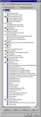

Another update, possibly the last one for Retro 1 for while. All that's left for it is testing all the games which means playing through them all. This'll obviously take a while...

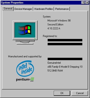

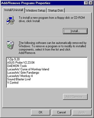

I have found my English version of Windows 98SE and installed that on Retro 1. My other license will be used on Retro 2. Played around a little with the desktop icon configuration (horizontal and vertical distance) to have the shortcut names displayed in their entirety and the shortcut icons closer to the right and lower edges of the screen.
All drivers are installed and working, there are no resource conflicts or whatsoever. The Voodoo5 is running with 4x RGSSAA for Grim Fandango and Escape From Monkey Island. When I'm playing through those two games I'll capture screenshots to highlight the exceptional quality and superiority of the 3dfx FSAA implementation and the huge difference it makes for such low-res games (640x480). The only additional software/drivers needed for Retro 1 (on top of the Windows 98SE installation) were:
  • - 3dfx Voodoo5 driver 1.04.00
    - Sound Blaster Live! driver, mixer, AudioHQ etc.
    - 7-Zip 9.20
    - ASUS Probe V2.23.04
    - DAEMON Tools 3.47 (for installing the Windows based games)
    - DOSBox 0.74
    - EIZO F520 inf files
    - V.Control
    - Windows Installer 2.0 (for DAEMON Tools 3.47)

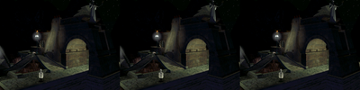

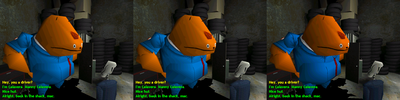

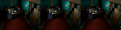

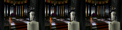

And I won't let you wait any longer 😀 The first set of comparison shoots! I always took a set of three and combined them into a larger image, unaltered of course. I used savegames to have identical images (except for characters with running animation sequences, but it should be OK).
The game's native resolution is 640x480. Back in late 1998 when the game was released, usually your CRT would display this resolution fullscreen without any issues (not like today, when displays can only support a single resolution without image quality loss...). As I said, my screenshots are unaltered, you have to increase the zoom to at least 200% to have a realistic perspective. Looking at tiny details like the paperwork on the secretary's desk, Manny in the third image, or hands and necks as well as all the borders of the characters in general really show the impact of the 4x RGSSAA. Manny in the fourth image is also a very good overall example of how great the game looks with it. With 4x RGSSAA applied you will quickly forget that this games runs in a 640x480 resolution!
From left to right, the configuration is: 3D hardware acceleration on, 4x RGSSAA on | 3D hardware acceleration on, no FSAA | Software rendering

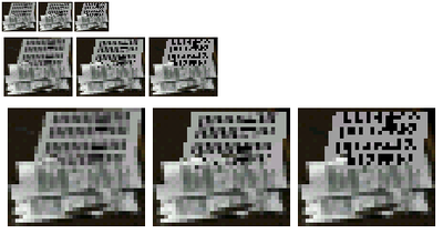

Reply 69 of 134, by voodoo5_6k
In addition to the full screenshots of the previous post I have prepared three special comparison shots before moving on with playing through the game. I have selected three details, and cropped each image to the exact same size. Then I arranged them again, like in the previous post (3D on, 4x RGSSAA on | 3D on, FSAA off | Software rendering). Then I created a version with 200% zoom and one with 400% zoom. Subsequently, everything got combined into a single image.
I think it is quite amazing what the 3dfx 4x RGSSAA adds to the game. And in motion it is even better. Back then, when my V5 was new, it made me play through many games again, just because I wanted to see them "enhanced" 😀 No other graphics card made me want to do something like that again, ever... To me, personally, this was an equally big jaw-dropper as was installing the Voodoo Graphics and launching a supported game for the first time a few years earlier 😲 This got me started on my "image quality crusade" 😉

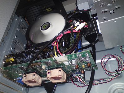

I'm currently evaluating the following system, just for fun...
    1.86 MiB
    2107 views
    Test System
It is an Asrock 775i65G R3.0 with an E5800 @3.2GHz and 512MB Corsair DDR400 running Windows 98SE. Obviously, there are no ISA slots, so no MPU-401AT 🙁 I'll be using a Roland Edirol UM-1 (USB MIDI Interface) which has Windows 98 drivers (already tested this on the current Retro 1). Windows 98SE is stable on this system, it ran 8 hrs. of Prime95 before I stopped the execution. Everything stayed cool and silent during that time, thanks to the Thermalright AXP-200 + TY-147A fan.
More on this soon...
