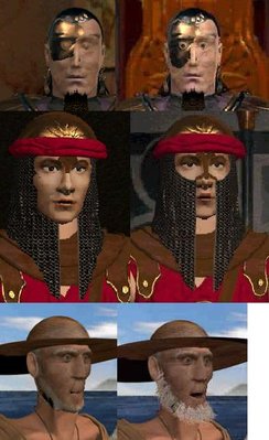

Can someone help me with Atlantis: The Lost Tales!
I've tried the GOG version, the game had a problem with the mouse (it was going really slow on puzzle mode) but I solved it by tampering Atlantis.exe with Hexedit.
The usual problem however persists. The graphics remain incomplete.
