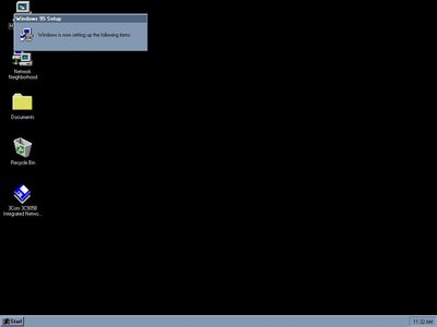

Every time windows boots up there is a box that pops up configuring windows, when it goes away desktop refreshes and my wallpaper is gone nothing but a solid background color.
Could it be cause im using a .jpg image Is .bmp recommended?

Reply 1 of 16, by Jorpho
Why don't you just try it and find out!?
I think JPG wallpapers required IE4 (Active Desktop).
Reply 2 of 16, by Oldskoolmaniac
I did and still same issue and I have IE5.5 installed.

Reply 5 of 16, by subhuman@xgtx
I think there's an update that causes this glitch. The same happened to me when I had 95c installed on my pentium mmx system.
Reply 8 of 16, by Oldskoolmaniac
I don't see active desktop anywhere.
I'm using win95c with the unofficial service pack and IE5.5.
When win95 logs in there is box in the corner that says "windows is now setting up the following item" my desktop refreshes then goes to a solid color background.

Reply 10 of 16, by Jorpho
You should check which items are running at startup, or just check Task Manager to see if there is anything unexpected running.
Reply 11 of 16, by Oldskoolmaniac
Got it working, had to reinstall everything like this Win95->IE4.01->IE5.5->SP1 Now everything is working great! I had no idea IE4.01 would change the whole explore layout.
Had to reinstall windows, i did the exact same same route and now im getting that same problem i cant even change to a solid background.

Reply 12 of 16, by SanguineBrah
Apologies if this is considered unwarranted necro but I think I have some useful information to add. I was having an identical issue to the above, also using OSR 2.5.
After a few reinstalls, I narrowed down the problem to the unofficial service pack. Without it, I am able to set and retain a (bmp) wallpaper but only if active desktop is enabled. I have yet to work out which component of the service pack is causing the problem.
Reply 13 of 16, by shamino
One other thing:
You can use the "Internet Explorer Administration Kit" to make a customized installer for IE5 or IE6 that includes Active Desktop. That way you don't have to install IE4 before the version you really want.
IEAK was a tool for sysadmins that lets you make an installer with customized default settings. One of the checkbox options is to include Active Desktop.
I did it with IE6 (for NT4) a long time ago, but I think the same process can be used on IE5.
Once you've made an installer you can just keep the file and never have to go through the IEAK procedure again.
Reply 14 of 16, by SanguineBrah
IEAK sounds like a handy thing to have around.
One more reinstall and I've solved my problem. This time, I used the lite version of the unofficial service pack instead of the full one. I still don't know which component was responsible but at least it's working as expected now.
Reply 15 of 16, by Oldskoolmaniac
That computer is long gone now, but I do have a win95 era laptop to mess with. Yea its definitely something up with the unofficial service pack. I'm thinking about trying this out https://www.razorback95.com/projects/win95dl/index.php
