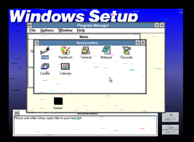

Somehow, it now gets up to the phase of copying the second font(helvetica), but then entering the path, the keyboard input is 100% unresponsive(should still generate packets though). Same for the MS-DOS 5.0 prompt, but not for the mouse input(which responds fine(serial mouse on COM1).
I'm testing with a 640x480 16-color VGA. CGA installed and ran without problems. So a 80186 problem?
Anyone might know the possible cause? The kernel is at least somewhat working now(GUI runs), but input troubles? A problem in the PS/2 keyboard still?
UniPCemu Git repository

Reply 50 of 142, by superfury
I've tested the following cases until now:
- IBM XT 8086/88 with CGA installs and runs Windows 3.0 without problems.
- IBM XT NEC V30(or 386, but don't remember for sure) with VGA running CGA windows that's already installed without problems.
- IBM AT with 80286 with VGA crashes Windows 3.0 in real mode, infinite looping or faulting.
- Compaq Deskpro 386 with 80386 & CGA doesn't POST completely(hangs after memory test as far as I remember).
- Compaq Deskpro 386 with 80386 & VGA has the same problem as the AT 286 & VGA.

I think the problem is with the CPU itself, seeing as strange (un)real mode problems occur on 80286+, as well as problems with the Compaq BIOS locking up on CGA. Also, I know that there's problems with add/sub instructions using carry/overflow/adjust flags(I'm currently trying to adopt those based on Bochs, see UniPCemu's latest commit's flags.c). The overflow should be accurate, according to the 80186 testsuite's sub test ROM. The problems with the carry/auxiliary carry(adjust) flags still happen in two of the tested cases with the current commit.
https://bitbucket.org/superfury/unipcemu/src/ … ags.c?at=master
Can you see what's going wrong? I've based it on the Bochs code of it's lazy flags(see the macro called bcbitsa/bcbitss(which indicates a bit has been borrowed/carried for addition(bcbitsa) or substraction(bcbitss)). Can you see what's going wrong? The check sets carry/adjust set to bit 7/15/31(depending on word size being 8/16/32-bits), while adjust/auxiliary is set to bit 3.
#define bcbitsa(v1,v2) (((v1)^(v2))^(((v1)^(dst))&~((v1)^(v2)))^dst)
#define bcbitss(v1,v2) (((v1)^(v2))^(((v1)^(dst))&((v1)^(v2)))^dst)
Overflow is now handled by indexing sign bit into a lookup table:
//Index Bit0=sumsign, Bit1=num2sign(add or sub negated value), Bit2=num1sign(v1)
byte addoverflow[8] = {0,1,0,0,0,0,1,0};
byte suboverflow[8] = {0,0,0,1,1,0,0,0};

Reply 56 of 142, by superfury
Just tried to install Windows 3.0 on the current CPU core. Something goes horribly wrong at the end, creating the program groups(VGA w/ 80188 emulation):
26.64 KiB
607 views
Windows 3.0 setup crashing creating the program groups.
Looking at the current emulation status:
CS:IP is 4900:0004. Previous opcode: 0x28(last executed opcode, not 0x0F opcode). Last opcode(actually current opcode): 0xFF. ModR/M byte is 0xFF. It isn't fetching anymore. The fault raising flag is set(so a fault has been raised).
