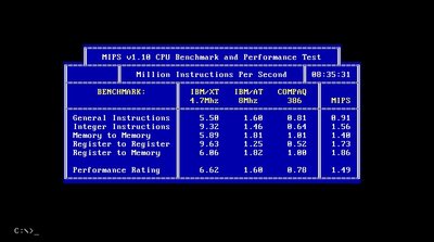

Implemented the 80386 string instruction timings(except INS/OUTS instructions), Page 2-52, Page 2-53, Page 2-54, disabled interrupt task switch timings(to be reimplemented on the 80386 task switching itself) and LSL only in byte granularity(still need to do page granularity, requiring slight instruction modification to detect).
The timings reported by MIPS are getting more accurate, but strangely enough, the integer instruction timings are still only 50%? The integer instruction should have been modified to run at the correct cycle counts?
433-80386 emulation getting more cycle-accurate_integer and processor control and jump instructions implemented.jpg
102.07 KiB
641 views
MIPS report within the current commit's 80386 core.
UniPCemu Git repository

I've just finished implementing all 80386 instructions in UniPCemu's cycle-information. 😁
The timings are now a lot closer, but for some reason some parts(like integer math) are still too slow, according to MIPS(two are very close, at x1.01 and x1.00)?
102.07 KiB
552 views
80386 timings fully implemented in the 286+ timings table.
Although, the 80386 0F instruction core itself still needs some adjusting to fully use the BIU for all memory accesses(which will slow it down some more, due to memory accesses currently taking 0 cycles for those instructions). Otherwise, it's theoretically fully cycle accurate(except for protected mode stuff like descriptor loading from memory etc., paging itself and task switching, which still operates without the BIU(although task switching should be relatively easily implemented, due to it being seperated from normal instructions already, within it's own EU unit, essentially)).
