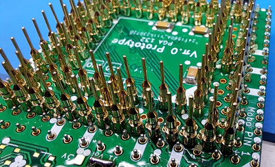

Awww, I ran out of pins for just now. Getting there on the first experimental one though!
197.12 KiB
1251 views
Some things I've done / noticed:
* I used another spare PCB to hold the pins in alignment for soldering: this actually worked pretty well and saved me having to buy the smaller PGA socket as a jig. Just put the pins in place, then put one of your spare PCB's on top to line it all up: hold tight and solder.
* I think this would be easier to work on with a HASL finish instead of ENIG. The gold is great, but you need to put a LOT of heat into those larger ground planes and I think having a little solder on the through holes from the factory would make for a stronger pin to board connection on the bottom end. It'll work out cheaper too probably.
* 'Painting' on some thick flux so it gobs in the through holes worked well for me: as the pins are inserted it coats them AND it is tacky so it actually holds the pins in place, even upside down!
* Once I've got the pins in, I'll use a VERY thin solder tip to do the socket from below: there is just enough clearance. I'm not sure how it can be done with the plastic on, so I just chipped the individual pins from the strip. This could all be done in a 'one-er' by putting the pins in a jig coated on solder flux, installing the socket with solder flux and then baking in a reflow oven.
* Method aside, I LOVE the look of these individual pins done like this, and they all make great contact with the socket. Also, of course, allows for MUCH easier repair later if I should damage a pin. Yes, this is MUCH more work, but I'm also using this as an exercise before I return to work after an illness, so it's helping my muscles and coordination.
Anyways, it's coming along slowly but surely! Oh, also! The cheap Chinese regulators came in and test out perfectly, and look legit, so that's good too.
Chris...

Yeah, it does kinda look a bit exotic without the plastic. Reminds me of a quantum computer

Right, finished this today and I'll give it a test tomorrow.
I can say with certainty that this was a complete bellend to build: not for the beginner! In the event I ever build another, hot air or reflow oven with solder paste only for me.
It could be made easier by taking the sockets and throwing them away, instead using strips of pins and strips of pin-sockets and alternating the sides you solder on, working out from the middle row by row. If someone held a gun to my head and told me to build one with a soldering iron only, this is the approach I'd take I think.
Anyways, we'll see if I let any magic smoke out tomorrow!! 🤣

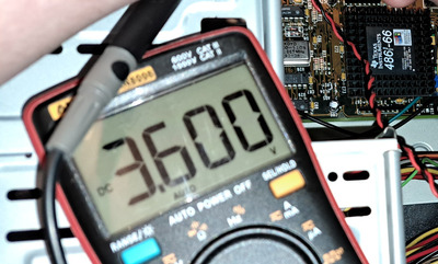

Well mixed results. At first I had the jumper set for 5v, all was OK with just the interposer in the motherboard...
Realised my cpu was 3.6v, so flipped the jumper over for 3v operation. Installed interposer, switched on machine to read voltages and set trim, and the PC speaker cable burst into flames.
Not.. quite... the result we were looking for. See attached for details.
Here's the odd thing, motherboard seems to still work with the old cpu back in it. 🤷 that's good at least, not sure if the speaker circuit is still good.
I wonder, what went wrong 🤔

That jumper is for a different cpu you want it in 5v for the sxl2 66
It’s for the vcc5 pin not the rest of the cpu
Edit: looking at your pic what cpu do you have there? Is that a sxl?

I just read your reply again. Did you not have the CPU installed when this happened? Because that 5/3.3 V jumper only goes to the J1 pin if I can recall correctly so it’s kind of impossible for that two of affected anything with the CPU not installed so I am kind of thinking that maybe you have an error in your assembly

Heres the cpu in question, attached. 3.6v. I -think- this is the 3v jumper option? I've read this thread until my eyes spin and there's no collected documentation, so hopefully that's the case? There is some confusion for me, because this IS a sxl2, which I read should have the 5v jumper set... and yet it says right on it, 3.6v.
But yes, you're right: the cpu was not attached. I thought it best to see about trimming off the voltage pot and observing any explosions before committing the cpu to the power 🤣
I have a working theory perhaps speaker was connected to KEYLOCK... which I think has a power LED connection. 5v right up the speakers jacksey? Yep, that might do it.
Unfortunately, when I saw the wires melt I snagged em out asap and didn't notice... my son swears blind he hasn't fiddled with this, but, hey, he might have: he's only six. 🤣
Ok, I'm going to remove the speaker totally and try this again... if any bad things happen it's OK this is a test mule I'm using.
Oh, yes, no assembly errors that I can see. Can't see under the socket that's soldered down, of course, but multimeter doesn't show any shorts so I'm thinking prolly ok 🤔

Set it to 5v
That jumper is for the vcc5 pin. J1 if I recall the alpha numeric coordinates. It is not the core voltage. It is a single cpu pin
We talked about that jumper early in the thread.
It is for a different related cpu.
Hopefully there is still a build guide and BOM coming from feopia? Fingers crossed.
Okay, if the cpu wasn’t attached then it is basically impossible that the jumper was the reason. If it was attached then maybe.
I think your keylock theory is probably correct.

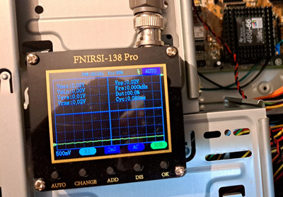

Anyways, the variable voltage works fine, the ripple looks to be all in spec (although cpu still not in so no load to be sure) so tomorrow I'll change the jumper back to 5v tomorrow and try with the cpu. 😁
