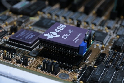

Reply 983 of 1213, by rafpereira
I was able to set clock double to 66mhz and 8k cache using a TI486SXL-40, and the TI486SXL2-50, even the slower variant seem to be stable at standard 3.6v
This board has a Kyocera 66mhz oscillator soldered, so I won't be testing at higher clock.
Compared to the DRx2 33/66 in this board with 128k 20ns cache, 1ws and isa clk/3 the difference so far has been minimal to TI486SXL2-66 advantage in the current configuration.

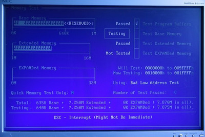

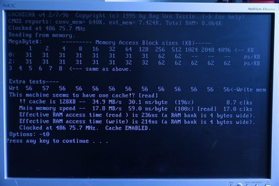

Reply 986 of 1213, by rafpereira
I changed the ISA clock from clk/3 to clk/2 and with regular fan cooling on the TI486SXL-40, boot in MSDOS 6.22, usual startup with himem, and cyrix -e -b -cd
then this sequence ran without a reboot or reset at 33mhz*2 (66mhz)
Phil's dosbench option:
b) Doom timedemo - Timed 2134 gametics in 9156 realtics
c) Quake timedemo - 969 frames in 452.4 seconds - 2.1 fps
m) Topbench 3.8 - 111
t) Cache test - screenshot
CheckIt 2.1 - Memory test - full continuous test (one full iteration done)
No lock-ups, no beeps, no bruises.
This setup/run does not look at all stressed at this clock, is there something specific you were looking for?

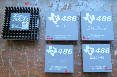

Reply 991 of 1213, by feipoa
He is saying that his 5V PGA-168 40/50 MHz CPUs run at 66 MHz, not the PGA-132 variants. I find this very surprising and will have to confirm on my end.

Reply 992 of 1213, by pshipkov
Yes, same here - regardless if 168 or 132 it is unexpected that to see that.
PGA-132 SXL-50 just do not scale well on fast boards. But on some slow ones they can get in the 60-65 zone ok with some effort.

Reply 993 of 1213, by rafpereira
To be clear, the PGA168 TI486SXL-40 mentioned (which compared to your picture does not have the "FC2-" marking), can enable, and I do enable clock double at 33Mhz FSB at 3.6v (not 66mhz FSB), the SXL was rated 40mhz FSB, so enabling clock double in the SXL for me was the only surprise. The specs call for 3.3v and 5v versions, how do we differentiate? (Never seen a V or G variant of the 40 and 50mhz)
https://ia903003.us.archive.org/35/items/bits … rence_Guide.pdf
at CLK/3 and 1ws setting, so far, I was unable to crash it no matter how many times I opened and closed IE5 on Windows 3.11 while on Solitaire. My current CF card is 1Gb and it is not setup for a MS Word, Excel installation.
I did install a Crystal CX4236B-X03 sound card and with Unisound I had a few games in SBpro setting: Jazz Jackrabitt (486DX2-50 setting, High detail, Turbo mode), Sam & Max, Tyrian, Darkforces... all with sound, and working as expected.
If I need to go and install NT 3.51 in this board, and spend time figuring out how to call cyrix.exe before the bootloader, then maybe I should ask if you have this installed in a disk image you can share. Going the long way will take me a while, and I am not sure it is worth for me.
Update: Windows 95 installed, Office 95 installed, Tom 2D benchmark ran for 6+ hours. Ethernet card added, IE searching on Google while Kayaker video playing. RAM upgraded from 8Mb to 16Mb.
Do you know what FC2 means? My SXL2-50 has it as well.

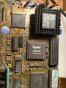

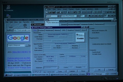

Had some time (and motivation) today to play with this some more,
Removed the varta,
Reinstalled the over clocking device (anyclk) using pins and reinstalled the factory socket
Put a housing on the removable battery pins
But none of that is interesting to this thread really,
Next I did a little investigating on the flt pin, wasn’t really able to see anything interesting or useful by examining the motherboard images without a processor available online next to the actual back of my motherboard, maybe I missed something but it seems that they may have actually not made this socket usable without modifying or removing the cpu.
So I did the pin pull up (physically) pull down (electrically) mod, but with a small wire and some kapton tape.
The system boots, but shows up as a frx 386dx in post. Is there a patch that can be applied?
Windows is even weirder, mentions cyrix instead (not a typo) in system properties.
Working on getting cpu z on the system.
    851.8 KiB
    1072 views
    1.99 MiB
    1072 views
Sphere's PCB projects.

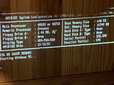

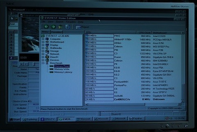

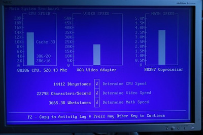

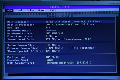

Reply 995 of 1213, by Sphere478
Well, I gave up for now trying to get phill’s or cpu-z on there. Cd drive isn’t reading RWs.. oh well. Shal resume at another time.
The system is a fair deal faster, so pretty sure it worked. I did notice that the boot summary screen was showing this now. So it was a success!
1.09 MiB
1065 views
Now to learn about the cyrix/TI registers..

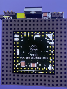

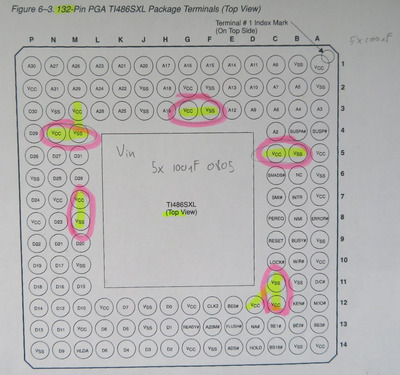

Reply 996 of 1213, by feipoa

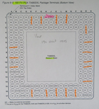

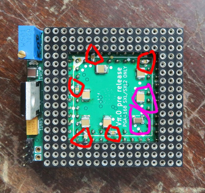

Let's see some noise measurements. For an equal comparison, run the chip in 1x mode at 40 MHz (no clock doubling), 4.05 V, and x10 low-inductance probe right on the VRM's pins. My results for both VRM options were 80-90 mV Vp-p.
What cap values did you end up with?
I'm using Cin1 ceramic 10uF, Cout1 tantalum 22 uF, and the others as shown below. I don't recall the exact values I used for Vin on the central region of the PCB, but they aren't important for Vout measurements. I tried these two configurations for the bottom PGA caps:
216.43 KiB
1048 views
164.74 KiB
1048 views
I suppose you could silkscreen these 0805 caps for the top pins. You can also silk the bottom Vcc5 if you wish.
189.16 KiB
1048 views
I think you should remove the three Vout capacitor pads on the bottom of the PCB entirely. In general, the Vin caps have almost zero effect to clean up Vout. IIRC, they helped reduce noise by ~5 mV only. As for the capacitor pads on the top of the PCB, if you are wanting to make the planes more robust, the below configuration is probably more than sufficient. Keep the purple circles, remove the other pads, and add silkscreen to where the red circles are. For consistency, maybe make the two remaining (purple) cap pads 0805.
349.38 KiB
1048 views
I'm not sure what else to alter. We are already nit picking.

Reply 998 of 1213, by Sphere478
I heard back from chkcpu,
Hi Sphere, In interesting project, getting a PGA168 TI486SXL2-66 running on a PGA132 socket board! Although I never did work on […]
Hi Sphere,
Although I never did work on these 386/486 1991/1992 BIOSes, I know that the AMI 1991/1992 core BIOS uses a quite generic CPU model detection. When it detects a 486, it looks for an FPU and displays a 486SX or 486DX accordingly.
So on the 12/12/1991 AMI core, even a DX2, or DX4 with interposer, are indicated as ‘486DX or 487SX’ CPU. But experience shows that it runs! 😉
So if the TI486SXL2 boots and runs, that’s all you need and Cyrix.exe will take care of the rest.
No need for a BIOS update or patch.
Cheers, Jan
I’ve been having trouble getting files on this system. It isn’t reading burned CDs for some reason, and the files are too big for floppies. I may have to get creative and hook up a ide drive. The system is scsi.

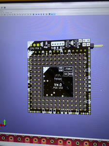

I’m voting for round pads, that whole D pad thing was a fiasco that I don’t think helped anything. The board is better with round pads anyway. I can make a note to elevate capacitors above pcb to deal with bridging conserns?
If you are really set on having the D pads I will add them back. 😀 Reminder though, jlc sometimes sends them clearanced for D but pads themselves are round. Another reason to just make them round..
Feiopa, could you whip up a recommended BOM with alternates and explainations for components as well as assembly notes I will include it in the final file. Kinda like a pdf instruction sheet for the end user ya know?
