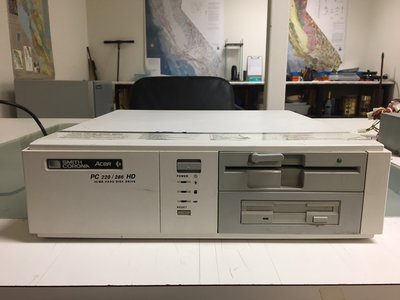

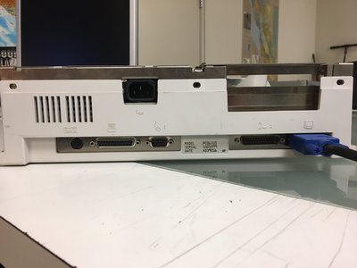

Hey guys, I came across this machine at the Salvation Army for $15, and I'd love to get it going. It's an Acer Smith Corona PC220, 286, built Circa 1991.
I never owned a 286, so my experience is limited. This one, from what I've read, is from a failed joint venture between Acer and Smith Corona, who only made computers together for a couple years. I did find a neat vintage sales ad that shows the computer and it's specs. Sadly the 40meg HD is gone.

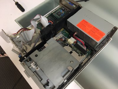

Unfortunately it wont turn on, and I'm suspicious of the power supply. It does have a Dallas Realtime DS1287A integrated battery, but I don't know if that would keep it from actually powering on. The front power button actually operates a metal rod that pushes an ON button that is IN the power supply, and when I do that I hear a click but nothing happens.
The power supply is different from other AT's that I've seen, because it doesn't have power cables for the drives. The molex cables come directly off the motherboard. Was this common? This means that I don't think just any old AT power supply will work. Part of me is naively hoping that it's just the switch inside the power supply, and not the power supply itself, but that's just wishful thinking. I would welcome any ideas as to how to troubleshoot this!
Sorry I don't have better pictures of the board, I haven't had a chance to fully disassemble it yet. But it is quite clean inside.

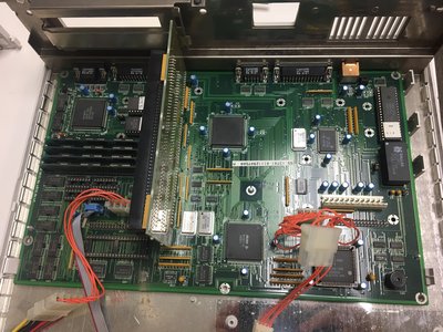

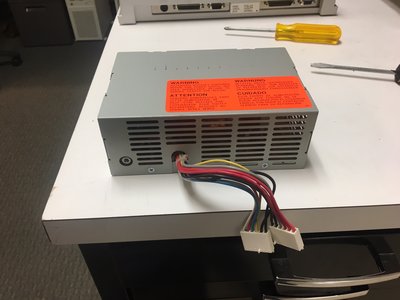

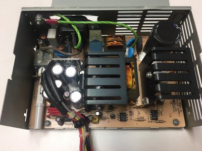

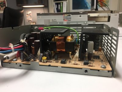

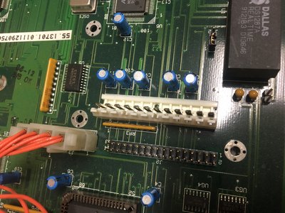

Hey guys,
Thanks for all the tips. Work is crazy the next few days so I've only had time to snap some better pictures and take apart the PS. I did remove the PS from the computer and it wouldn't power on even by itself. Of course I can't load-test it like that, because there are no rails/cables coming out of it. All the power cables for drives/fan etc. come from the MB itself. That must be uncommon?
Anyway, here are a few pictures. The fuse in the PS looks unbroken to my eyes, but we'll have to see.

Reply 13 of 25, by Cyrix200+

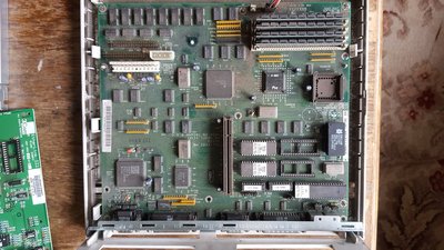

Reply 16 of 25, by brassicGamer
Indeed it is uncommon - my Acer 386 is the only PC I've ever seen that has the same arrangement - it was a way of keeping things compact, I guess. I recently used a splitter to power an additional hard drive and a 5.25" floppy drive from the PSU. Probably shouldn't have done this as it's rated at a pathetic 43 Watts. It got really hot, as it's passively cooled (as is yours). Have you managed to find any documentation for your system online? I have found a grand total of fuck-all. Definitely try to get this system working as they are super-super-rare. If you have a multimeter, you could check the continuity of the fuse or, if you don't, you could make a simple circuit from a battery pack and an LED using the fuse to complete the circuit (or not, as the case may be). Unless anyone with more electronics experience than me can explain why this could be a really bad idea?

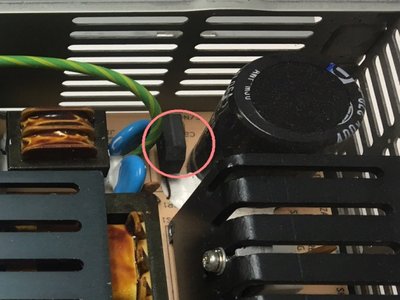

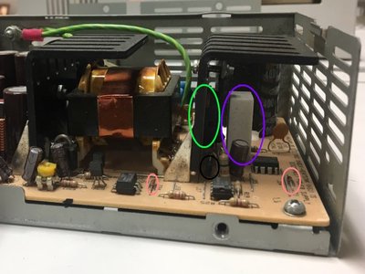

It's difficult to say what's broken.
The transformers don't look that healthy, but maybe that's just because of heat/grease.
I would check :
- diodes (little red and big black ones)
- power transistors
- regulators (green circle)
- huge ceramic resitors (blue circle)
- caps
Also have a look at the thing I circled (pinkish). That's either a power mosfet, triac, thyristor or some sort of regulator.
If it is defective, the power-good circuit wont't allow the PSU to power up.

Reply 18 of 25, by gdjacobs
The pink/salmon circle is around the line input bridge rectifier. Watch out, as the output legs on that thing will be energized with quasi-DC at ~340V when the supply is on and until discharged. At that voltage, the bulk caps discharging in your body have enough energy for a good chance of stopping your heart.
Reply 19 of 25, by Jepael
If nothing else looks broken, one common point of failure is a high-valued resistor (often largish in size too) that feeds the switching controller from the main bulk cap before the switching starts and can provide power to it.
